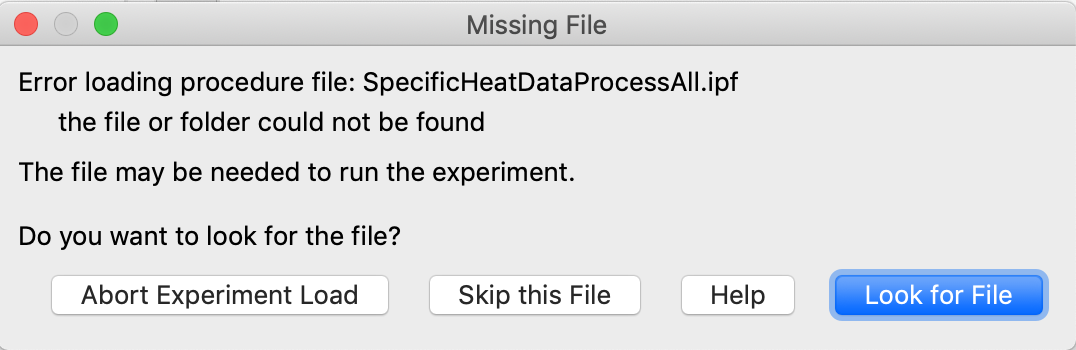

I guess your real file is called "SpecificHeatDataProcessAll.ipf".

Your SpecificHeatDataProcessAll.ipf file is likely just offscreen. So when you select the Windows->Procedure Windows->SpecificHeatDataProcessAll.ipf menu item, that procedure window is brought to the front but you can't see that because it's offscreen. The solution is to then use the Windows->Control->Retrieve Window menu item. Yo could also use the button in the tool bar (it's the button with one green arrow pointing left and one window).
