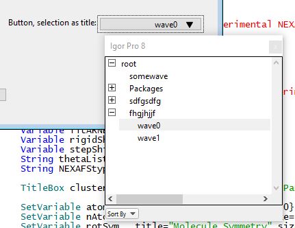

Probably a question that's very easy to answer. I'm making a panel that allows me to run a function I wrote from it instead of using the command line. I have a decent handle on setting up buttons, checkboxes, and Set Variable controls and I've been using them to set up the panel succesfuly so far. It's the first time that I'm trying to use the waveSelectorWidget so I looked at the WaveSelectorWidgetExample.pxp file to try to implement it. I was able to get the WaveSelectorPopUp functionality working onto my panel (i.e. I can click on the button, get the dropdown menu with the different folders, and browse through the data folders to look for and select the wave I want, [picture attached]) however, I'm unsure as to how reference the wave I have selected with the widget.
One of the procedures included in the example "DemoPopupWaveSelectorNotify" , takes the path to the currently selected wave as input and prints it out into the console. I also noticed that the help text associated with the button is also set to the path to the wave which is exactly what I need but I'm unsure as to how to get that.
