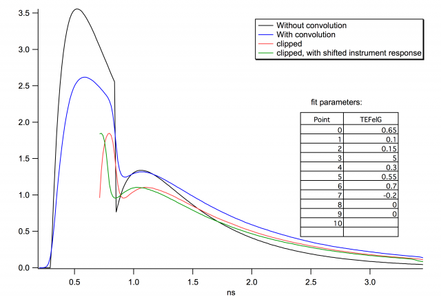

The problem starts when I want to fit a small section of the curve - the outcome is the red curve in the plot. There is clearly an issue with the convolution on the left side of the curve. I've found I can improve the curve by shifting the instrument response (green curve), but there is still an artefact, and now the right side of the curve is affected as well.

I was wondering if anyone has encountered this problem before. I believe the standard way to deal with this would be to add data points to either side of the curve with linear regression, and remove them again after convolution. However, this doesn't seem very elegant, since I already know how the curve will continue on either side (I just don't want to include these data points in the fit). Another idea that I had was to fit the entire curve in the Curve fit dialog, but then use two extra fit parameters to define the range I really want. I'm not sure though how Igor will react when my fit function return less data points than it was given.
