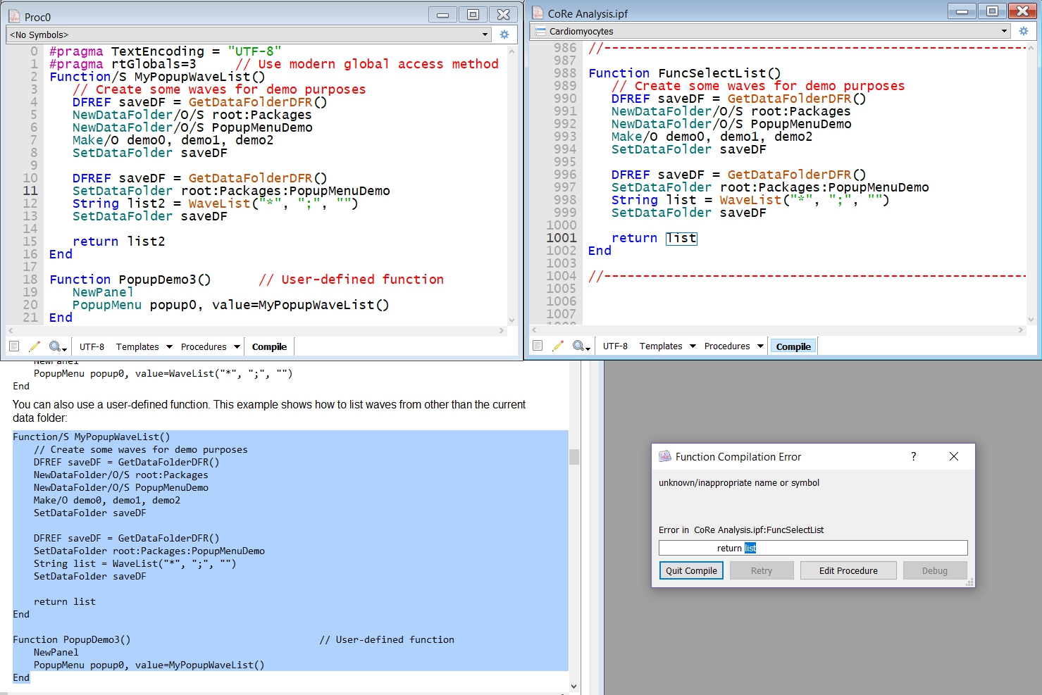

I can see how plugging in a function as a value sort of makes sense, but something like  ModifyControl seemed to make more sense. I am sure there is a good reason for this.
Unfortunately I'm getting a compiling error when trying to use the exact code given as example from the help files.
I do not have any other "List" strings in my code that could originate any sort of conflict (even if this is a local string variable) - nonetheless I get a "Unknown/Inappropriate name or symbol" error (??!!).
Check screen-shot attached.
Any idea why this behavior?
