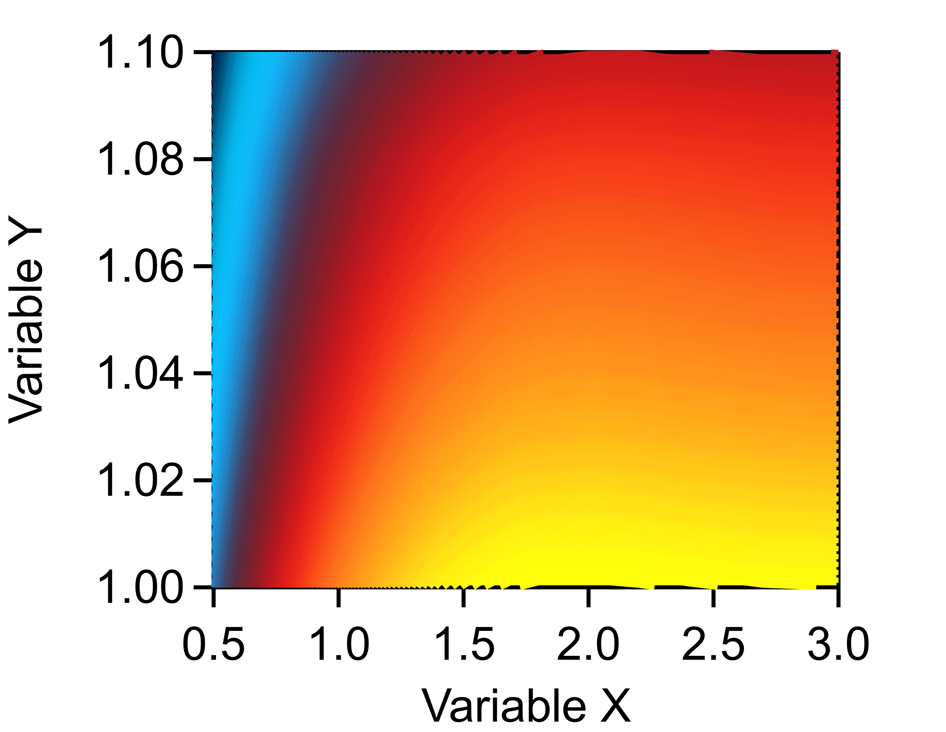

Can axes be plotted above traces?
I was wondering if there is any way to make axes appear above traces (by default they appear below).
I would like to do so because when plotting certain figures, such as contour plots (see example attached), the traces are visible lying above the axes. I guess that the standoff feature was indeed intended for this purpose but, sometimes, a tight frame just looks better.
In the modify axis dialog, select "Draw on top of traces" for each axis.
From the command line: ModifyGraph axisOnTop=1

In reply to In the modify axis dialog,… by tony
I can't believe I haven't found that... sorry for bothering
Thanks Tony!
