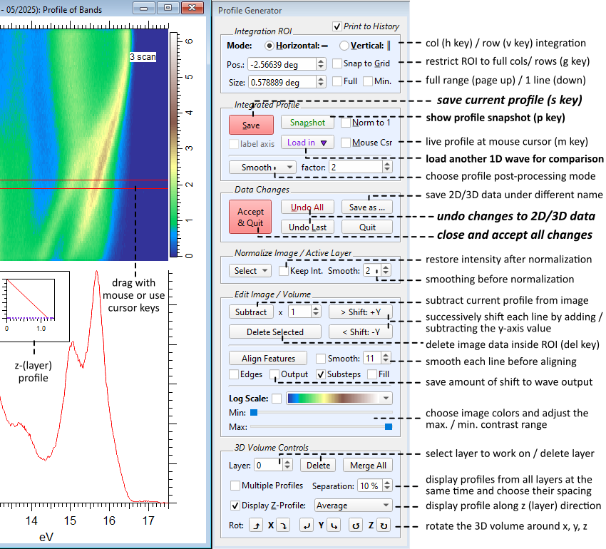

User Interface controls
To start, select a 2D or 3D wave in the Data Browser and then go to ‘Spectra Tools’ -> ‘Image Profile …’ in the top menu. Or use the command line:
SpectraProfile(inputWave)
A quick overview of all controls can be found below:
Line profile controls
- The profile can be calculated in horizontal (h key) or vertical (v key) direction. Diagonal or free-form modes (like in the Line Profile tool) are not available.
- The Region-of-Interest (ROI) lines can be modified via the control variables, by dragging the lines directly with the mouse on the image or by using the cursor keys on the keyboard (holding the shift key speeds up movements by 4x and the ctrl / command key slows down movement by 1/2). Holding both the ctrl / command and shift keys slows the movement down to one delta unit (one row / column) for precise placement.
- To instantly go to the full (minimal) ROI width use the respective check boxes or use the page up / page down keys.
- Normalize Profile: The profile (not the image) will be normalized to fall between 0 and 1.
- Mouse Csr Profile: An additional profile appears for comparison, which shows the current row or column under the mouse cursor (toggle with the m key). This profile is not saved.
- Snap Lines to Grid: The ROI line positions are constrained to include only full rows / columns.

Image contrast and color controls
You can choose the used color table and adjust the contrast of the image or currently selected layer by using the drop-down menu and the adjustment sliders. Select the desired color table and slide the Min and Max controls until the contrast is as desired. The sliders only have a range between the maximum and minimum data value of the image or currently selected layer, so the contrast cannot be reduced further, only increased. If you reverse the position of the Min and Max sliders then the colors of the image will be inverted. Check the log scale checkbox to switch to a logarithmic scale for both the image and profile. Switching to this mode will not work if the data only contains negative or zero values.
Additional controls for 3D data (volumes)
Layer and Merge controls
The Layer setting chooses the currently displayed layer of a 3D data set. The profile will only be created from this layer and most functions for editing data will only act on this one layer (there are exceptions like Delete ROI Section and Shift). The Delete button will delete the currently shown layer. The Merge All button will merge all (remaining) layers into a single 2D image which can then be worked on further. This can be reverted by using the Undo buttons. The scaled position of the current layer will be displayed in the top-right corner of the image.
Displaying profiles from all layers
Activating Multiple Profiles will show profiles of all layers, which are generated from the current ROI, simultaneously for comparison with the main profile from the current layer (shown in a bold line). This is useful, for example, to follow small changes in signal throughout the layers. The Separation control can be used to change the vertical spacing between the profiles. This spacing is in percent of the maximum y value. These profiles will also be saved in a wave with the ending "_map". The maximum number of profiles (layers) for this functionality is 100.
Clicking Display Z-Profile will open a small graph which plots the change of intensity in z- (i.e., layer-) direction. This can be useful to track variations across layers. The type of information displayed can be changed via the pop-up menu. Currently average, maximum or minimum intensity can be selected.
