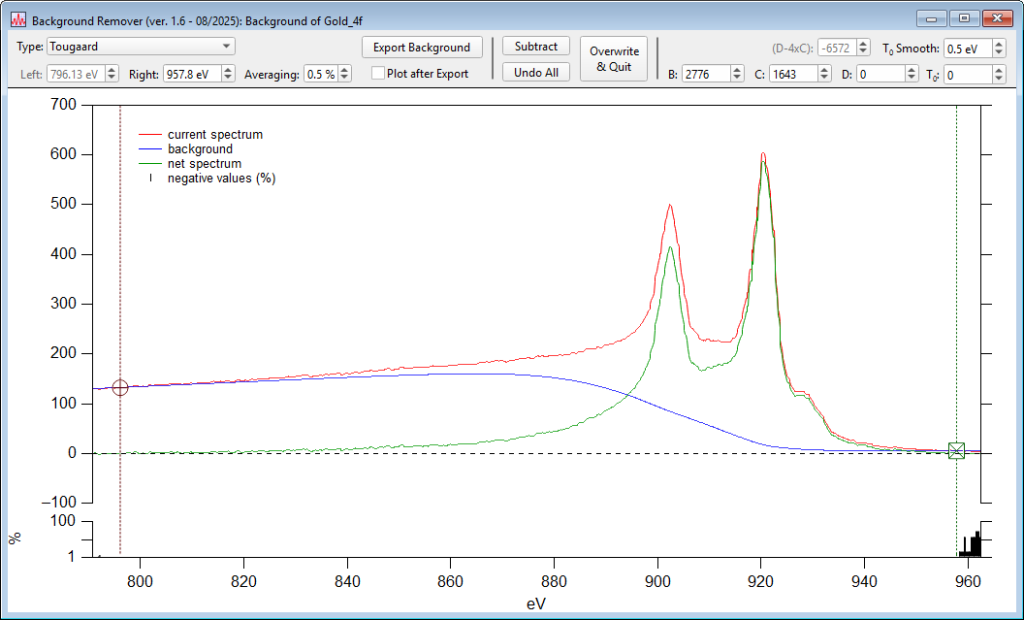

Basic controls in the user interface (UI):
Select a (1D or 2D) wave in the Data Browser and then navigate to 'Spectra Tools' → 'Background Subtraction ...' in the main menu or use the command line:
BackgroundSubtractGUI(mydata)
Controls:
- Type: Select the desired background type.
 - Left & Right Cursor: Modifies the cursor positions, which indicate the effective range for background calculation. Cursors can also be dragged directly by hand.
 - Averaging: The data intensity around the cursor positions is used as input for anchoring the background. Here, the data is averaged over the set range to smooth out noise (a value of 0 will switch off averaging).
 - Export Background: Exports the background (blue; name ending "_bck") and the subtracted data (green; ending "_net") into the folder of the input.
 - Plot after Export: Creates a separate plot of the exported data.
 - Subtract: Subtracts the current background (blue) from the data and then continues with the subtracted data. You can successively subtract multiple types of backgrounds one after another.
 - Undo All: Reverts to the initial data.
 - Overwrite & Quit: Overwrites the input with the current result (red trace). Will not have any effect if nothing was subtracted.
 - Background-specific controls will appear for each background type, and their function is explained via tooltips when hovering the mouse cursor above each control element.

Included background types:
- Constant: Simply subtract a constant value.
 - Step: Smooth step function which connects the two marked endpoints (this uses tanh(x) as the step function).
 - Linear: Linear function through the two endpoints.
 - Exponential: Normalized exponential function connecting the two endpoints.
 - Double Exponential: Double exponential function fitted within the selected range.
 - Polynomial: Polynomial function fitted within the selected range.
 - Total Sum: The total sum inelastic scattering background after X. Li et al., J.Electron Spectrosc. Relat. Phenom. 63 (1993) 253-265
 - Shirley: The iterative Shirley inelastic scattering background after A. Proctor and P. A. Sherwood, Anal. Chem. 54, 13-19 (1982)
 - Tougaard: Three- and four-parameter universal scattering background after S. Tougaard, Surf. Interface Anal. 25: 137-154 (1997)
 - Tougaard Data: Scattering background using scattering cross-section data after S. Tougaard, Surf. Interface Anal. 25: 137-154 (1997).
