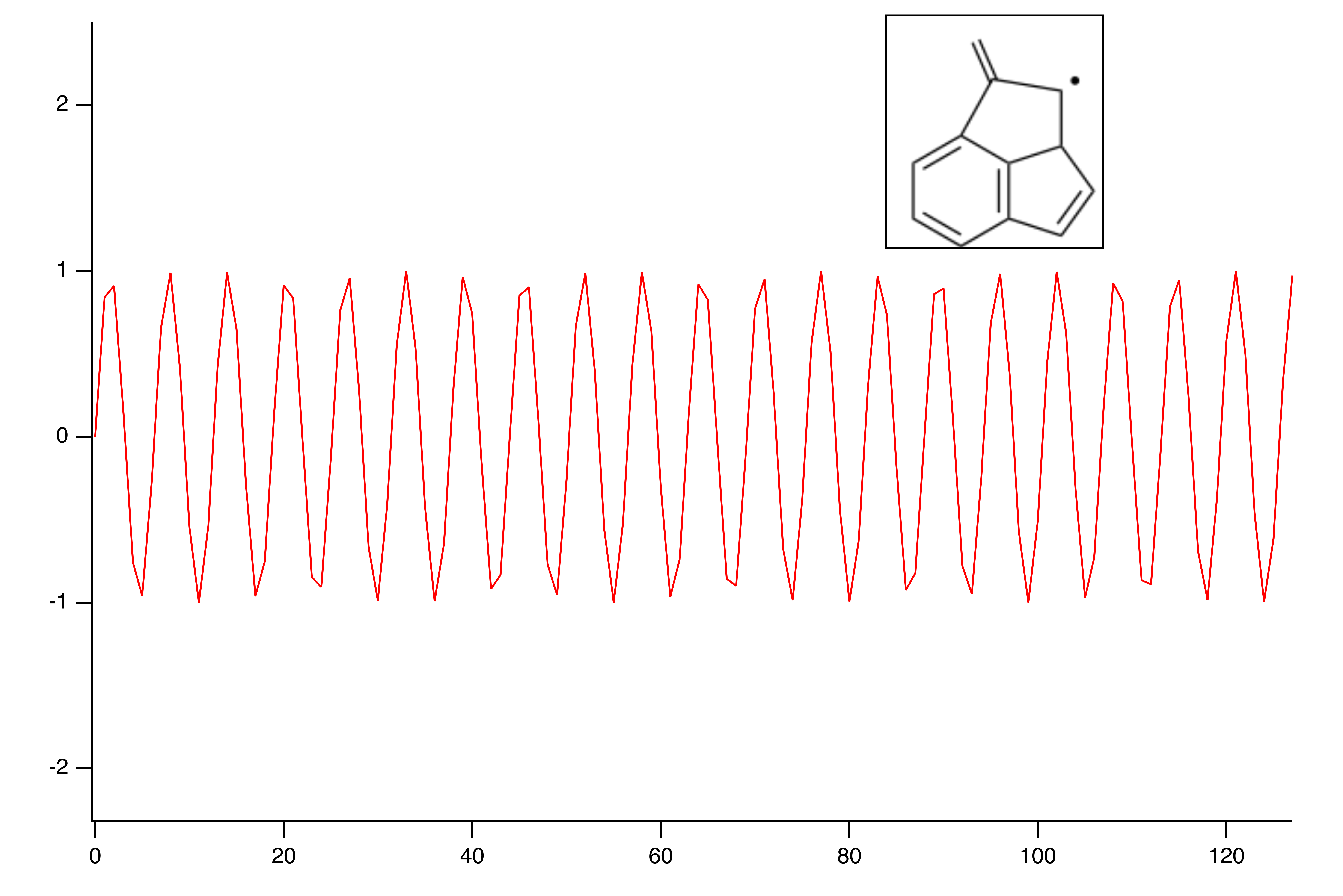

Insert an image into a box in graph
I wish to insert an image (png, jpeg, etc.) into a box on a graph. See example.
Molecular structure diagram
Here is what I did.
Under Misc>Pictures  load the image into IP.
Then with you graph on top, Go back to Misc>Pictures and select the image and press Place Picture in Draw Layer.
The activate tool and the drawing tools. Click on  the image (you will need to place the cursor on a black portion or it just reads the background).  Once selected place where you like.  The with the drawing tools, make a surrounding rectangle and set the fill to none.
Deactivate the drawing tools.  I grouped the image and bounding box just to make moving them easier.
Inserted image (501.61 KB)
