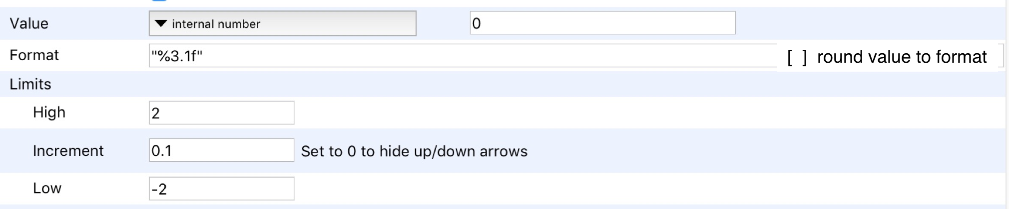

I have this recent thread about increments on SetVariable controls.
I would like to have a simpler way to implement rounding of values on SetVariables. I propose an additional checkbox as shown in the attached image.
My expectation would be bug reports of values that weren't quite what people thought they should get. We get bug reports on arithmetic in a steady trickle.
With this control panel:
This action proc does what you want:
You still don't get exact values, of course. This "rounding" results in slightly different values than simply incrementing by the digital equivalent of 0.1, so the results in some cases change the greater-than and less-than relationships to the intended exact decimal number:
So to summarize, I think trying to round would result in unexpected results just as much as not rounding. You can implement your own rounding, and get a result that you can inspect in detail rather than burying it in our source code. And you can adjust your rounding to get the results you need.

So, let me try to summarize all this. Consider the case where you want a setvariable control to increment from -2 to 2 in 0.1 steps. You want the steps to be EXACTLY 0.1.
You have two ways to make this happen within a SetVariableControl structure function
Method I - Read sval
Method II - Read dval
Of the two methods, the first seems the easiest.
When you wish to read the panel value using ControlInfo, you are out of luck with Method I. The ONLY way to force the value from ControlInfo on a setvariable is to use the approach below where MyRoundedValue is a function to force the value to a given precision.
My request was to have a checkbox to make the rounding happen behind the scenes so that ControlInfo would automatically format v_value as it was read by ControlInfo.
In this regard, I might amend my feature request to this ...
I would like to have ControlInfo on a SetVariable also return a value V_FValue where V_FValue (or a more appropriate name) is the value formatted according to the format string provided in the settings. When the format string is empty, V_FValue is the same as V_Value.
