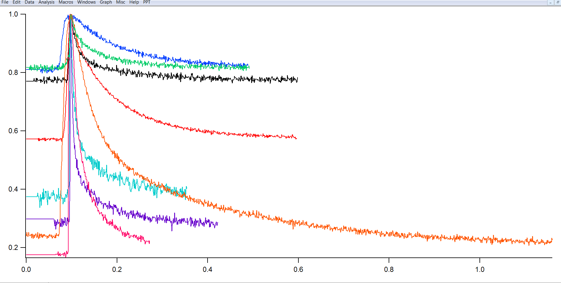

First I'd recommend normalizing all the waves so that the baseline is at 0 and the peak is at 1. Right now there's some pretty significant vertical offsets, so averaging the waves is going to give you nonsense due to that nonzero baseline. This is relatively easy to do using the Wave Arithmetic panel under Analysis-Packages-Wave Arithmetic.
Once they're normalized, there's another package that can give you the average. If all the waves are in the same plot like you've shown, just use the Average Waves package, also under Analysis-Packages-Average Waves.
After you have the average, you'll want to fit the average to your rising/falling exponential function. Go to Analysis-Curve Fitting..., then make a New Fit Function... for your function. You might start with just the falling exponential, using the cursors to select just the falling part of the data to get some reasonable guesses.
I would suggest to go the other way round: Find a fit function that uses a vertical offset, a time offset, and an amplitude f(t)=y0+A*(1-(exp(...(t-t0)...) etc. and average the obtained and relevant parameters afterwards (I guess the time constants). No need for manual normalization and peak shifting necessary in this case. In addition you can estimate whether an averaging would be meaningful (scatter of the fit parameter results).

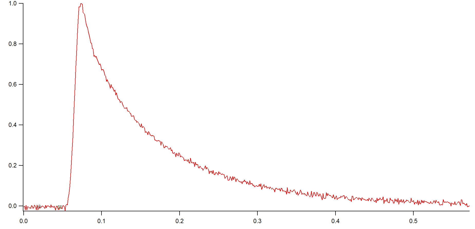

My motivation for waveform averaging is to determine the best representation of N waveforms by finding their average. The background story is that, I need to design software that can automatically determine such representations of the data without expecting the user to input any sort of initial values for activities such as curve fitting. In short, I want this to be done in as automated a manner as allows. I appreciate any more feedback from the users ! Let us discuss further. Thanks.
[quote=Supriya Balaji]My motivation for waveform averaging is to determine the best representation of N waveforms by finding their average. The background story is that, ...[/quote]

whats the best way to make the waves go from 0 to 1?
I merely subtracted the minimum and then divided by the new maximum. Is that a good method ?

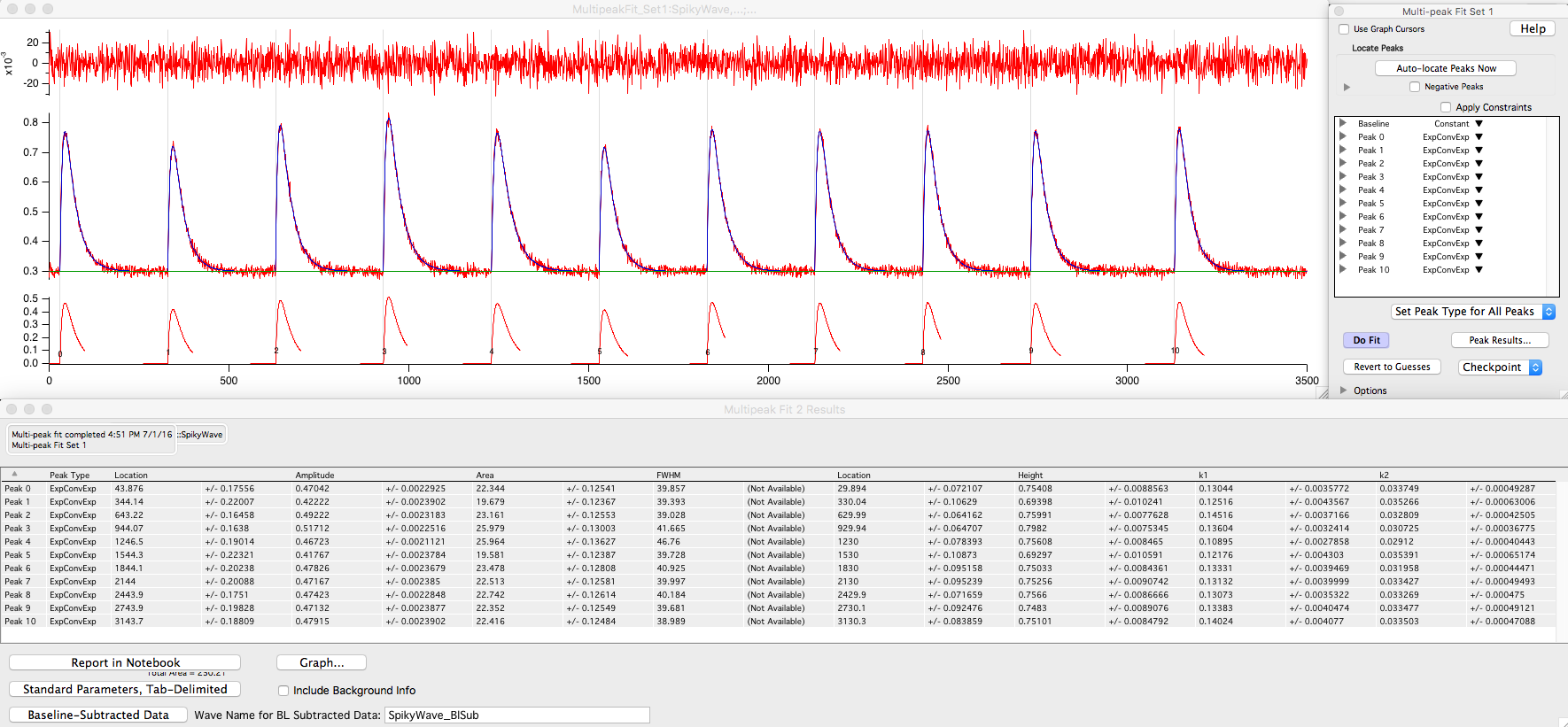

f(t) = exp(-t/decaytimeconstant)-exp[-t*(1/risetimeconstant+1/decaytimeconstant)] = exp(-k1*t)-exp(-k2*t)
Luckily, ExpConvExp is included as a type of peak in the Analysis - MultiPeakFitting 2 package. That package is also pretty fantastic at auto-guessing peaks and parameters, so it doesn't take "hours" of fiddling to get a good fit. I highly recommend familiarizing yourself with the Multi-Peak fitting package by trying it on some of your waves. The Help button has a pretty comprehensive set of documentation.
What's more, there's built-in functionality to automatically fit a bunch of waves using the MPF2 package. For example, if you wanted to fit wave0, wave1, and wave2 to the ExpConvExp peak type, first load the package then enter this at the command line:
The result will be a set of data folders PeakResult_0, PeakResult_1, and PeakResult_2 that contain the wave PeakCoefs0. The four coefficients are Location, Height, k1, and k2. Of course you can modify the inputs as needed; documentation is in that "help" button.

I suspect that by averaging the waves you are significantly distorting the overall shape, and the double exponential decay would be more sensitive to that distortion than the single exponential. It probably depends highly on how you do the offset and normalization before averaging -- which is why it's better to do the fits first before the average as others have pointed out.
[quote=Supriya Balaji]whats the best way to make the waves go from 0 to 1?
I merely subtracted the minimum and then divided by the new maximum. Is that a good method ? [/quote]
AG gives the best answers here when you want to use the min/max approach. My concern with using the min/max approach is this: It is not statistically valid because your raw signal has noise. Consider when your data has a spike. Your normalization will be thrown off dramatically.

As @ajleenheer notes, the reason you get strange results is because the run-to-run curves WHICH ARE DIFFERENT FOR EACH RUN (my emphasis) are totally distorted by averaging.

1) User chooses a few spikes(about 10) from a large data trace consisting of ~100 spikes or more
2) Program will subtract baseline, normalize spikes by amplitude and then cluster them into less than 5 groups based on their similarities to each other
(The spikes in any one cluster are similar to each other,and yes, their time constants are very slightly different but not widely varying from each other.)
4) Each cluster will now be averaged to find the Wave_Average. Program will use pre-set guesses to fit the average wave with the following function
5) The reason I want to stay away from fitting all spikes is , to make this process as user-independent as possible. Even pre-set initial guesses will involve user-intelligence and while it is unavoidable, I want to reduce the incidence of user-inputs.
What is your advice on baseline subtraction and averaging ? I tried to subtract the mean of a spike-free , noisy region and got good results. Attached is the normalized spike image showing the region that i originally used to subtract baseline. Thanks for your interest !

Now that you've explained you have a "spike" train as raw data, I really recommend the Multi-peak fitting data package. I've attached an image simulating what I think you're doing; the part that took me the longest was generating the fake data.
Igor does a good default job at auto-guessing Gaussian peaks as long as your signal-to-noise ratio is decent. The tricky part is converting those Gaussian guesses to the exponential rise/decay. The Multi Peak Fitting package takes the gaussian amplitude and width and translates those into starting guesses for the ExpConvExp function (which in your case includes just the single exponential decay function). In my test, those guesses were sufficient to get a good fit to all the peaks when I hit "do fit." But, I suspect that if you know what your data generally looks like, you could tweak how it converts from Gaussian guesses to the ExpConvExp guesses. That conversion is done in the function GaussToExpConvExpGuess(w) in the PeakFunctions2 procedure window.
If the double-exponential decay is critical to you, you'd have to write your own function for the Multi Peak Fitting routine to use. Let me know if you need help with that. I'd take a three-step approach: (1) let Igor auto-find the Gaussian peaks using the Multi-Peak Fitting package; (2) convert those gaussian peaks to ExpConvExp peaks and do that fit; (3) convert the k1 and k2 fitting constants as reasonable guesses for your "risetimeconstant" and "decaytimeconstant" values that feed into your custom peak function, and do the final fit.
You don't have to do this from the Multi-Peak fitting GUI; with a bit of work, you can call the Multi Peak Fitting routines from its functions for programmers as I alluded to above.
In this approach, you get all the fitted constants for all the peaks. After the fact, if it's important to you, you can bin them by similarity, average them, graph the average, etc. But you avoid the nonsense of trying to extract data out of a bunch of peaks that have been offset, normalized, and averaged, perhaps incorrectly due to the noise.
You would need to create a procedure to generate the list of waves, possibly using the function TraceNameList("",";",0), then call the MPF2_AutoMPFit() function, then dig through all the PeakResult_n folders to extract the various fitted coefficients. Not too bad.

Here is the intended design
(1-exp(-t/risetimeconstant))*(Amplitude1exp(-t/decaytimeconstant1))+Amplitude2*exp(-t/decaytimeconstant2)) + Amplitude-baseline

I also think that if you know a priori that the data sets will always have a peaked shape (a decay upward to the peak plus a decay downward to the baseline; double exponential with opposite amplitudes) it shouldn't be too terribly hard to write a routine to automatically generate the initial guesses. Then you can have a fully automated way to do multiple fits without involving the user.
July 1, 2016 at 03:53 pm - Permalink
