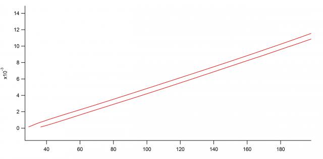

But I don´t know how to make the iterations! I mean the first value should be the point 3616 minus the point 16070, the next point should be 3615 minus 16071, and so on. The final point should be the last pair of values (that´s why I have put i>235, because for i=234 there is no more points in the wave.)
This points should be stored in a new wave with exactly the same number of points that iterations have been made.
I think that the problem in my procedure is in the definition of the for loop. As you can see, I don´t have any idea about programming, but I try to learn by myself :)
#pragma rtGlobals=3 // Use modern global access method and strict wave access. Function/D iteration () Wave wave variable i, ii i=3616 ii=16070 make/O/N=??? new_wave for (i=3616;i>235;i-=1) new_wave=wave[i]-wave[ii] i -=1 ii+=1 endfor end
Attached you´ll find the graph with the wave.
