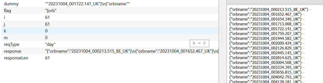

I get strings obtained from an api in json format for example
{"orbname":"20231004_000213.515_BE_UK"}\n{"orbname":"20231004_001652.467_UK"}\n I want to extract all entries such as 20231004_000213.515_BE_UK etc
I have tried things like
dummy = StringFromList(5,response,":") dummy = ReplaceString("orbname",response,"") dummy = ReplaceString("}\n{",dummy,";")
where response is the string from the api. The problem with this is that the quote characters remains in the string. How can quotes within a string be removed from the string? Previously I have done this sort of thing by using a loop and search strings and something like outputString = response[pos1,pos2] but am looking for a neater way to do it perhaps with lists or similar. I don't particualrly want get involved in json.

Fortunately its not now proving too difficult for me. The debugging view of strings seems quite accurate and helps.
