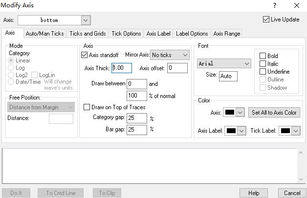

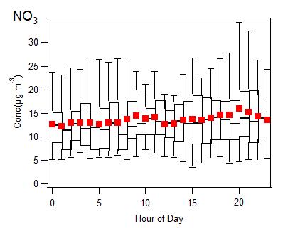

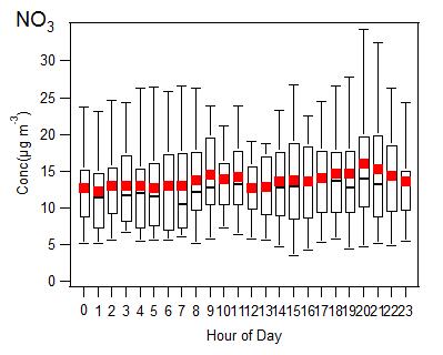

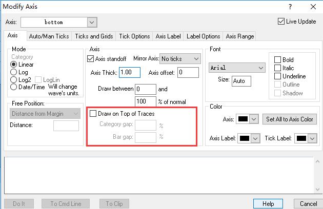

Thanks for your help. Now I can use "modifygraph" to change the trace. Now I have some new problems. I use the hour as txt format displaying on my graph and I make the "txtWave" by "Make" operation. However it looks to crowed on the axis and I can not modify it(for example, I cannot set major ticks, minor ticks or tick increment ). Then I make a number wave to display hours of day. Howvever, two new problems exist. Firstly, it seems that the middle of bars on the gragh"diurnal_by_number" were not aligned with the axis number precisely. Secondly, I can not modify the "category gap" and "bar gap" on the "axis" of "modify axis" dialog any more and all bars were lined together, which I want to change.

I post the two pictures which x-axis were txt and number respectively. Would you please help me solve the problems?

The best way to get help on a complicated question like this is to create a greatly simplified example that shows the problem and post an Igor experiment containing the example so that others can understand the problem and try various solutions.
Rather than spending lots of time creating box plots with procedure code, you probably should try the Igor 8 beta. Box plots are built in in Igor 8.
