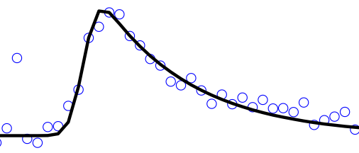

I'm a new user of Igor, so I'm not familiar with it. I need to write a code to fit data. The fitting function is a convolution between a Gaussianand an exponential decay which is multiplied by the Heaviside step function. (Gauss)x(exponent*step function). Such that for negative values of the independent variable, the product (exponent*step function ) is zero. Should be something simple but I couldn't do it. Is there any idea? Thanks a lot

I have found a code but I can not so far to include the HS step function.
I have attached the file may be it is interesting for you too. Just you need to have a wave for the coefficients.

Giannis, note in your attached file (copied out of the Igor manual) that this line:
expwave = (x>=0)*pw[4]*dT*exp(-pw[4]*x)
does, in fact, implement the multiplication by the step function. Note the "(X>=0)" at the start of the expression; it has a value of zero when X < 0 and 1 when X >= 0. Please be sure to read about the limitations of the first, easy implementation of convfunc()
