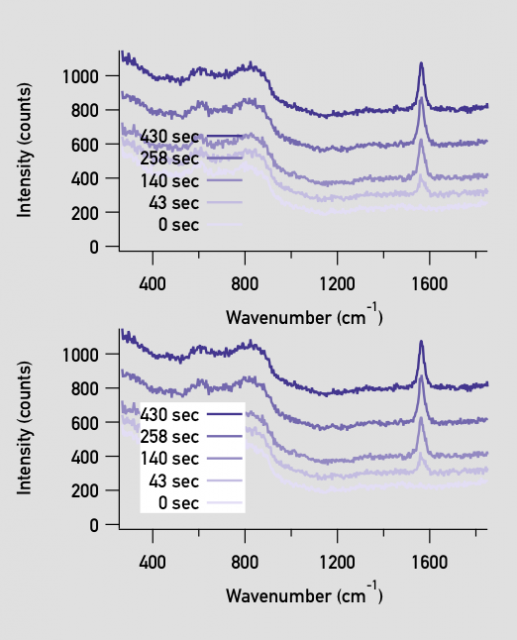

I have a slight issue. I'm currently making a poster for a conference that does not have a white background. (I despise white, boring backgrounds.) Instead it essentially has a very light grey background. Not much different but it sets it apart enough to be noticed.
Anyway, all of my graphs have transparent backgrounds to avoid the ugly "white box" around graphs. However, the legend cannot be transparent because it is on top of some parts of some traces. If I make the legend transparent, the traces can be seen behind it which makes it really hard to read.
What I WANT is for the legend to block the traces behind it, but still be transparent so that when I put it over top of a light grey background, I don't see a white box around the legend, is that possible? Alternatively, I could simply make the background for the legend the exact same light grey, but then that makes the graphics one use only, specifically for this poster using THIS grey. I like to make graphics I can reuse in multiple places.
Both attached graphs are BAD. (I've artificially darkened the grey behind to accentuate the point I'm trying to make.)

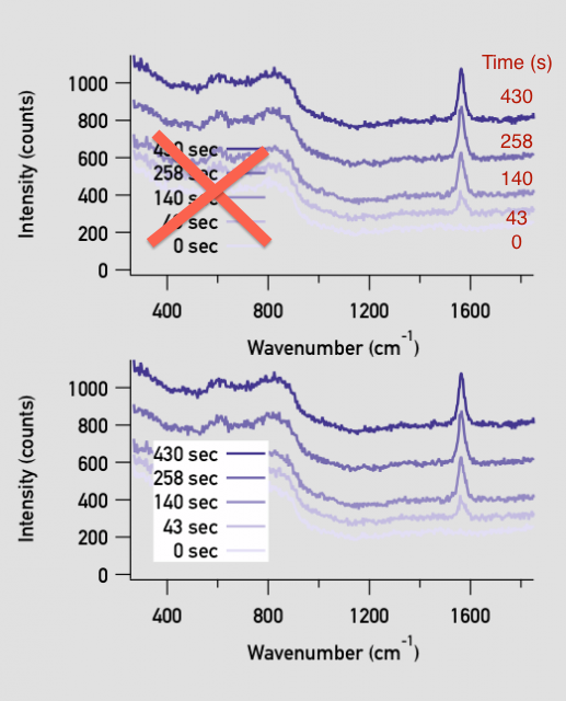

When you stick with a transparent background, then perhaps you should do the example below instead. The red stuff is my editing.
BTW, the lightest purple on gray is impossible to read. Are you really sure this is where you want to go? Are you really sure this is attractive to the majority of your audience (and not just a whim that _you_ insist they should all accept, difficulties and nuances be damned)? Lots of good stuff comes in plain white wrappers, and lots of good stuff gets swallowed in the results from folks who go unnecessarily toward fancy on borders and colors and legends and other things.
