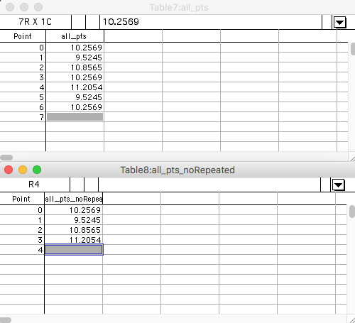

I have a wave "all_pts", it contains float numbers. I want to remove repeated values. Example is shown in image. I want to have a wave similar to "all_pts_noRepeated" , as you see in this wave, values 10.2569 and 9.5245 are removed because they are repeated.
what is the easiest way to do so?

Try out FindDuplicates present since IP7.

Histogram might also be an option

You could also Sort the wave and Extract the points that differ from the previous points

As I recall, when dealing with floating point values you should incorporate a tolerance in your matching. That is, consider values to be the same if within "+/- alpha" of the value.
