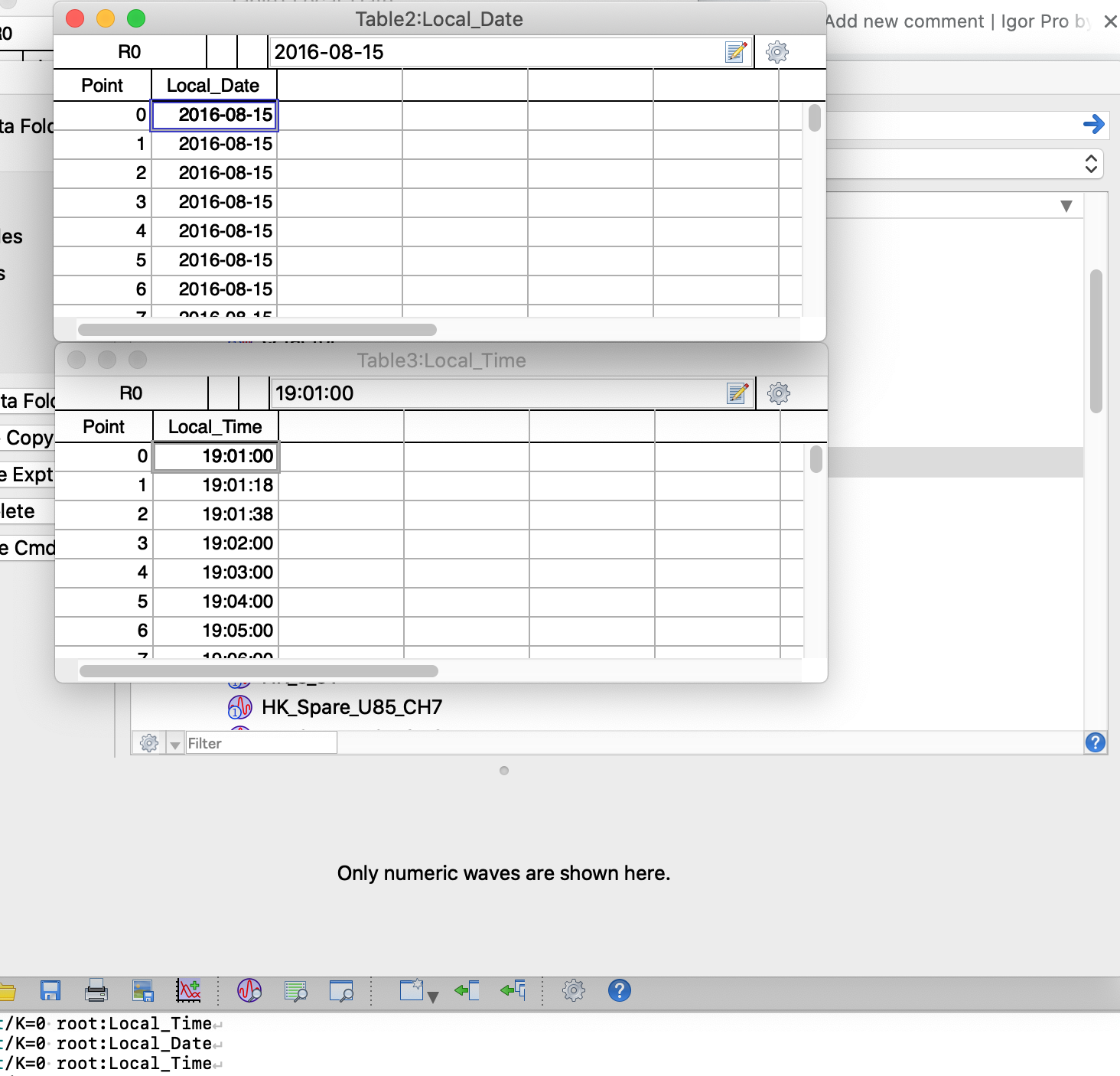

Thank you. I imported them as text because they won't show correctly at the time part with added 01/01/1904 (UTC?). Here is the screenshot of the date and time columns. Is there a direct way in Igor pro to combine them to a new "date-time" column as the excel does? I didn't do it in Excel because the dataset is too long to be read into Excel, but Igor has the capacity to read the data.

I have posted a snippet showing how to do this conversion.
It would be better to import the date as date/time. If you attach a sample file or sufficient subset of a file, I will see if that is possible.
