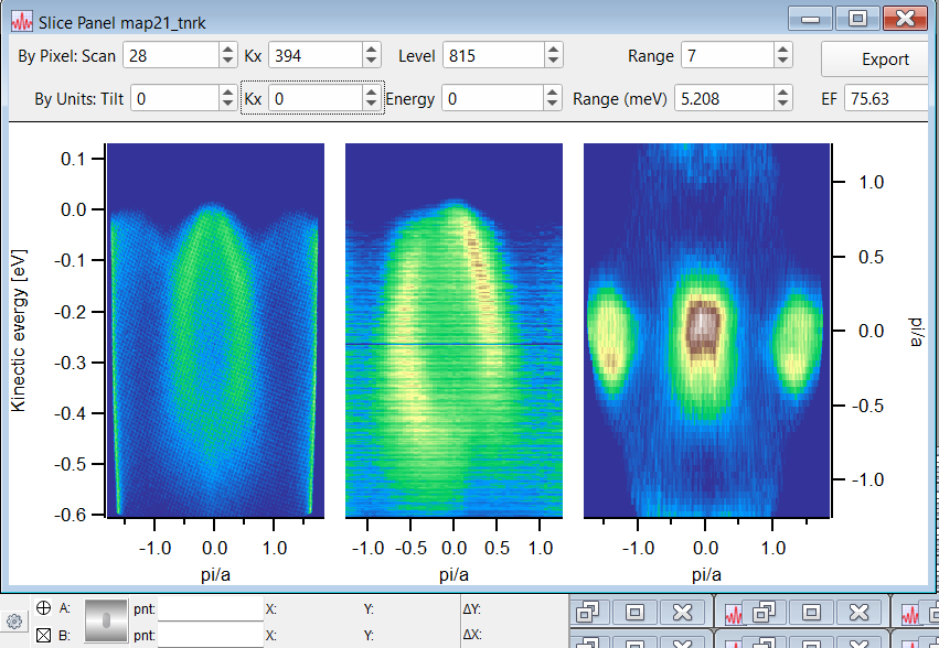

I have a procedure (annex) that generates a panel to manipulate different 2D cuts of a 3D wave. The original wave is "map21_tnrk" and the middle panel is "map21_tnrkb". This is shown below.
I want to duplicate a given cut of panel b and make a graph with the image, so I run the following code •Duplicate map21_tnrkb map21leftpocketXZ •Display;DelayUpdate •AppendImage map21leftpocketXZ •ModifyGraph tickUnit=1,standoff=0;DelayUpdate •ModifyGraph manTick(left)={0,0.2,0,1},manMinor(left)={0,0} •ModifyGraph mirror=2 •ModifyGraph margin(left)=51,margin(bottom)=48,margin(right)=13,margin(top)=13 •ModifyGraph fSize=12 •ModifyGraph lblMargin(bottom)=10
However, when I change panel b of the procedure window, the duplicate is also changing.

Your code uses SetFormula which creates a dependency by which one wave is automatically updated when another wave changes. Use the Misc->Object Status dialog to determine what dependencies exist.
For background information:
DisplayHelpTopic "Dependencies"
August 10, 2022 at 10:19 am - Permalink
