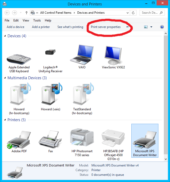

It's a bit more work than I remembered on Windows. In Windows 8 (and probably also Windows 7 and Windows Vista):
1. Open Control panel.
2. Click View Devices and Printers.
3. Click on the icon for your printer.
4. Click Print Server Properties in the band that appears just below the menu bar.

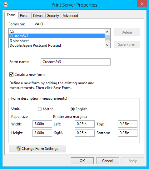

You are now in the Print Server Properties dialog.
5. Click the Forms tab.
6. Click the Create a Form checkbox.
7. Enter a name and dimensions for your custom page size.
8. Click OK.
You can now select your custom paper size in the Page Setup dialog in Igor. After selecting your custom paper size, enter your desired margins before clicking OK because, in my test, the margins I set for the custom paper size did not appear by default in the page setup dialog.

However, I cannot follow the suggestion. I am using Windows 8 and a Dell 1355cnw Color MFP, and I do not have "print server" or "forms". I have "printer properties" and "printing preferences", but there are no forms.
I suspect that you have it. I think it is part of the OS, not part of the printer driver. I have attached screen dumps that illustrate how it is done. They show how I created a Custom5x3 paper size. Although you have to select a printer icon before the "Print Server Properties" link appears, the new paper size appears for all printers on my system. Look at the second screen dump (Printers.png) first.
