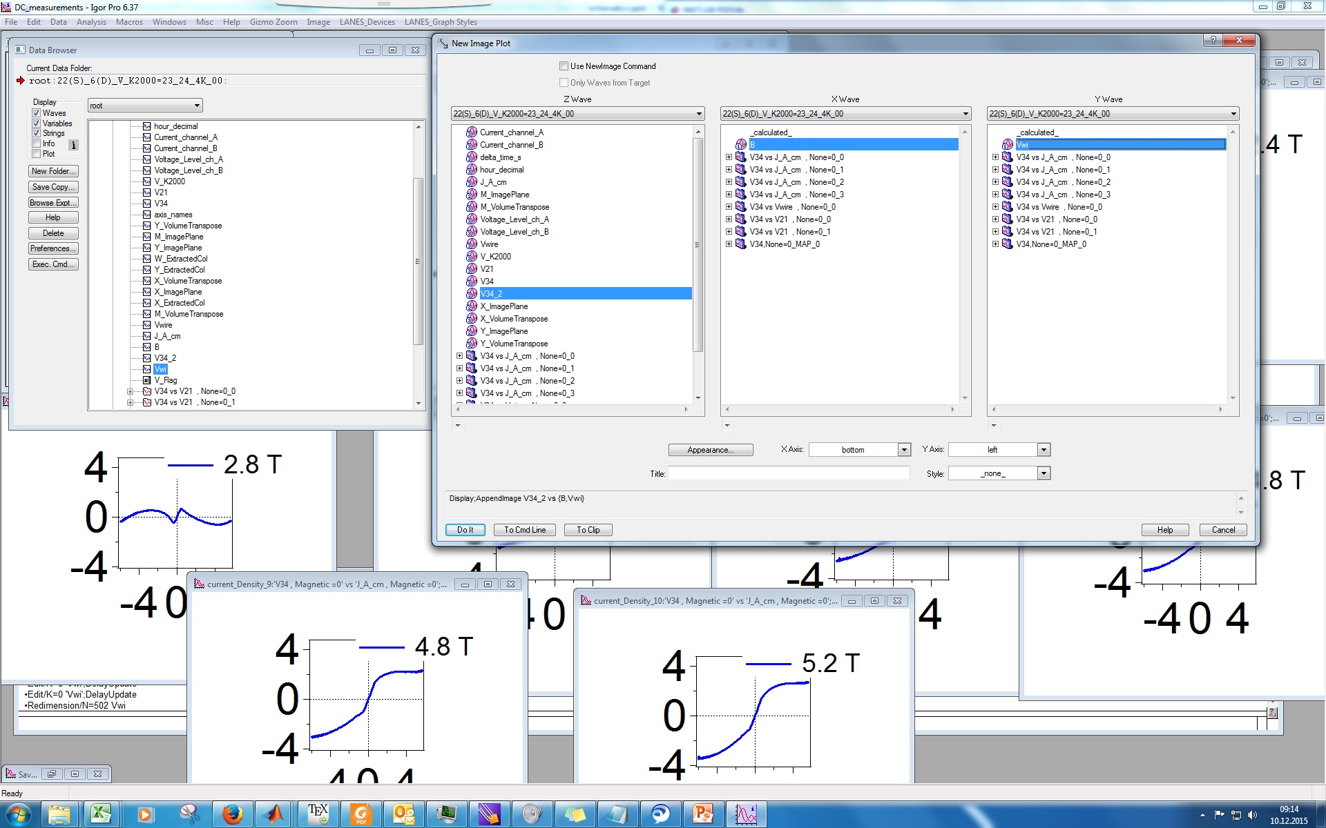

I want to plot a 2D image where the colour of each pixel represents the value of a 2D matrix. After reading from the manual, I created the X and Y wave used for defining the pixel height and width. In particular I have a 501X199 matrix, so a created a 200 elements X wave and a 502 elements Y wave ( I add one element in both wave since I read this from the manual). When I created the image from Windows->New->Image Plot, I specified the 2D matrix and also the X and Y wave that I have created. However the result that I got is not properly. Could you help me? I'm using Igor 6.37 on W7.

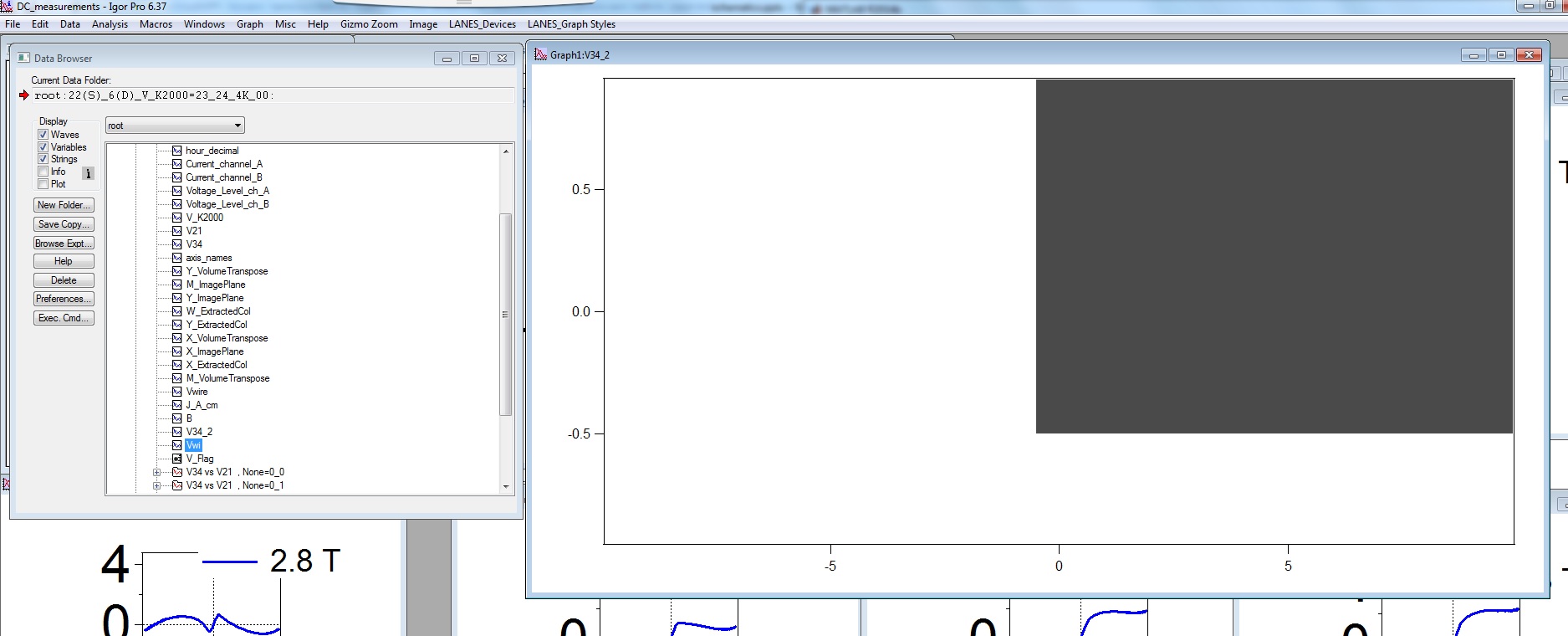

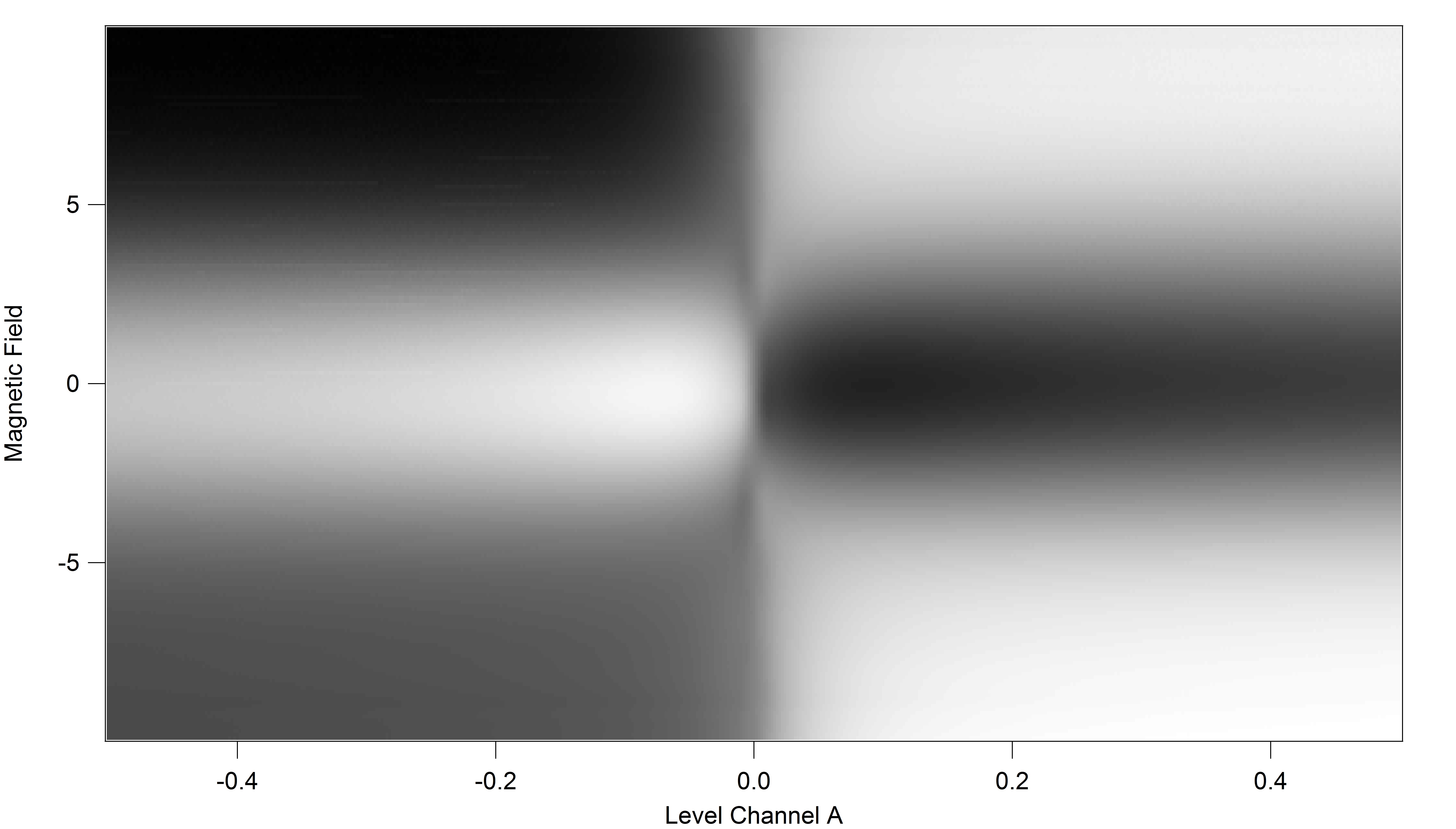

PFA three pictures that explain what I did, what I got and what I would like to have. In my case V34_2 is my 2D matrix of size 199X501. B is a vector of 200 evenly spaced elements and Vwi is a 502 unevenly elements vector. From the picture, you can notice that the plot that I got is not properly scaled in according to both B and Vwi (the values shown on the X and Y axis are right) and this is my first big problem. The second problem is that I would like to have B on the Y axis an Vwi on the Xaxis. Could you help me?

You can use wave scaling for the B values, since they are evenly spaced.
For debugging purposes, what does a plain
Display;Appendimage V34_2
look like?
But to really help you, it would be best to get an experiment from you containing only V34_2, B, and Vwi.
To solve the second problem use swap X & Y axes in the Modify Graph dialog.
Hello, thanks for your help. PFA the experiment containing all the needed data. I tried also the debug command but the result is not good, so I would still need your help.

The error message gives you a hint. The last two values in Vwi are equal and the wave does't monotonically increase. Setting VWI[501] = 1 or so should help to generate the plot.
