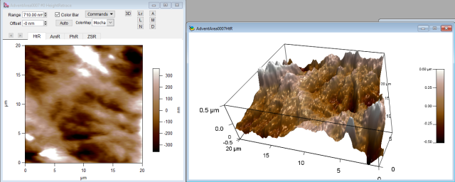

ggm877
I know I can write a script to generate the x and y data as the points are evenly spaced and then assign the z values from the height retrace to these values to create a wave with x, y, and z info but would prefer an easy way to extract all 3. Moreover, I'll be overlaying this 3D topographical data with elasticity data, is it possible to extract that data simultaneously with my 3D cartesian data in a way that will maintain the spatial relationship?

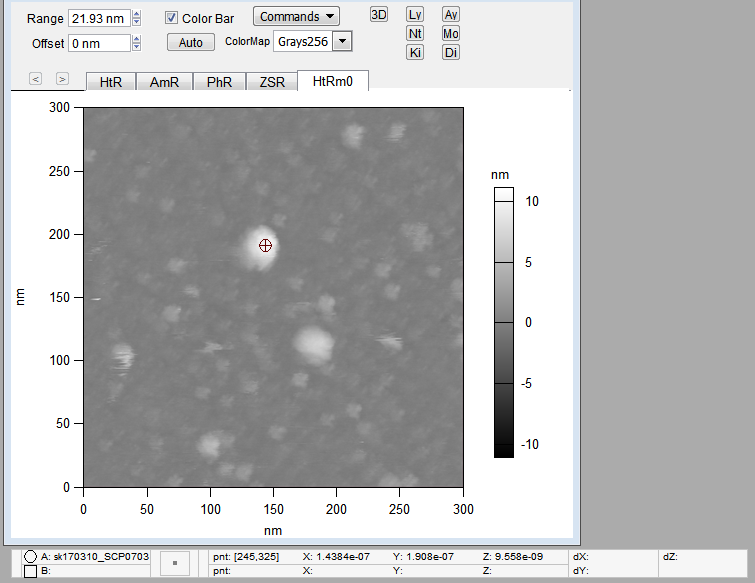

The images captured by an AFM are always multi-dimensional, no matter how the data is represented. In the image on the left the color coding encodes for the height data (HtR tab selected, R stands for retrace).
All it will take to get the triplet (x,y,z) is to position the cursor wherever you want on the image on the left. How do you do that?
You would call the info pane by pressing
ctrl+i
or issuingshowinfo

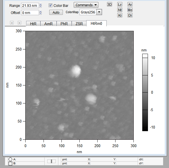

when the left window is top window. The pane will appear below the window (see attached image: image1.png)You wold drag and drop the cursor on a feature you would want (see image: image2.png)
Now if you want to read programmatically the positions of the cursor/s, you would have to look for the following set of functions
hcsr(); vcsr(); zcsr();
. (i.e.)Good luck!
