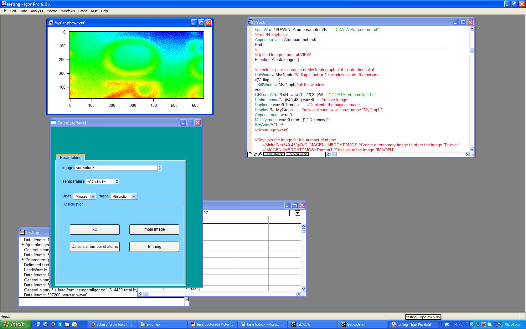

I have one image and I want to apply binnig action in this image.
for eample in binning 2*2:
The shape of the image should be the same.
The count per pixel should be increased by 4.
The matrix of the image should be reduced by 2 in each exis.
Could someone suggest a way I can proceed here?
I load my image with GBLoadWave.
I attach my igor as a picture.
Thanks

My main goal is the matrix of the my image reduce by 2 in each exis because I want use tha Gauss2D fitting.
My Image is 640*480 so it has a lots of points, I like to use binning for reduce this points.
I use your code but after execute it, nothing happens in my graph!
I need your help!!!
