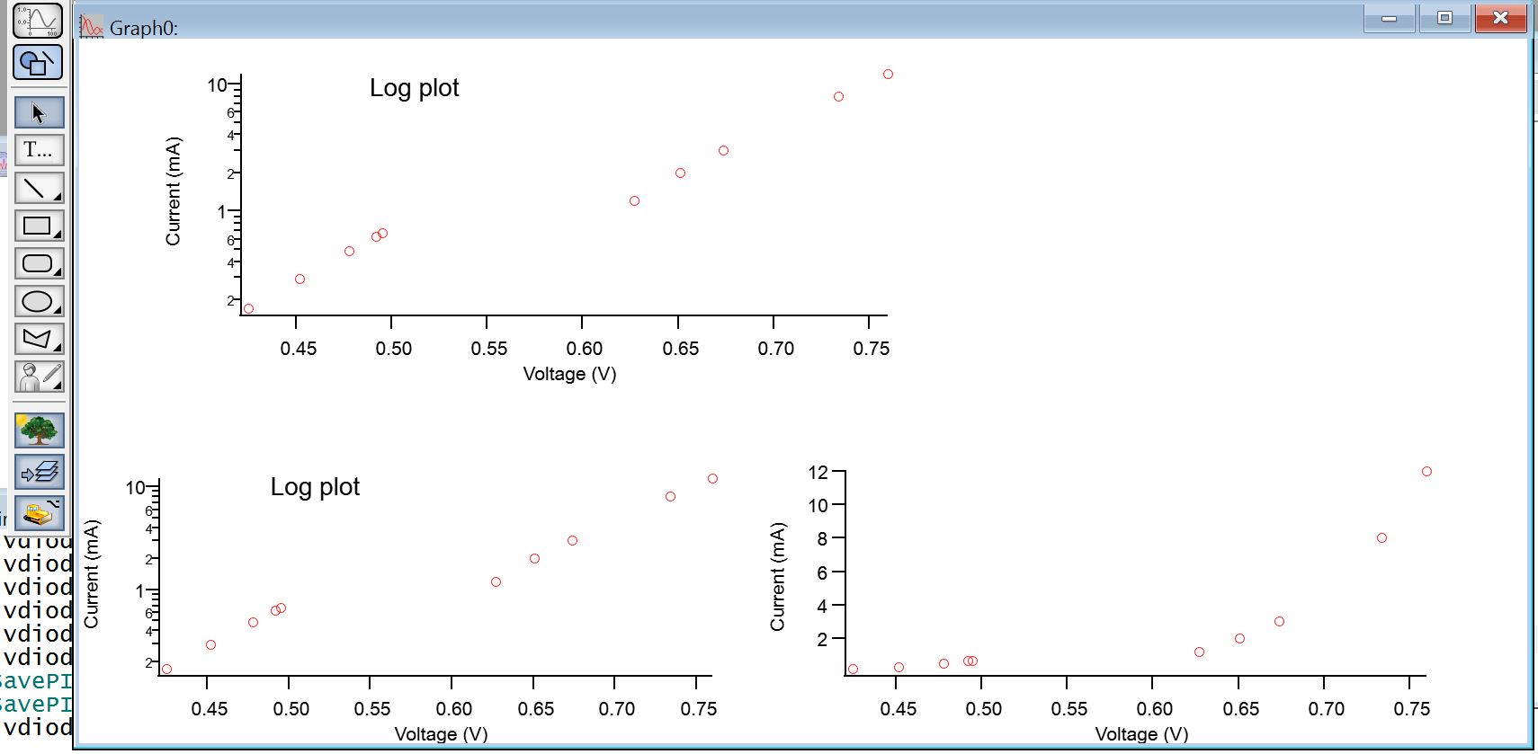

Save the recreation macro.  Control-Y to bring up the dialog.  All the code used to create the graph as currently displayed is now in the procedure window.
One side note:  The image shows the graph in tools mode.  If you save recreation marco it will also save the tools mode open.  When I build GUI I have remember to turn off tool mode before saving.

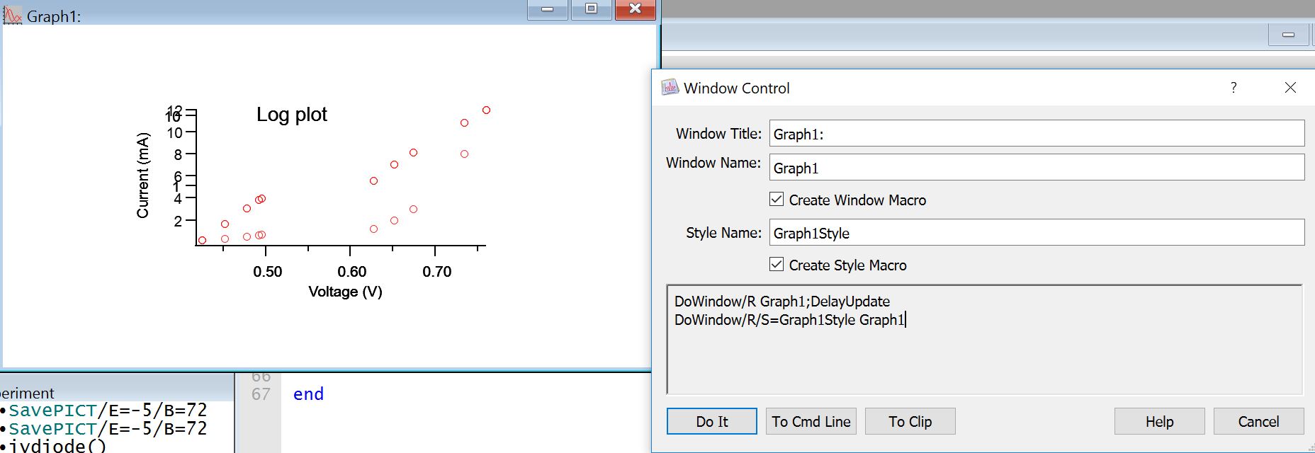

Thank you for the response.
I don't think I am doing this right though.
As can be seen in the image attached, I do get a block of code I can add to my ipf but when I run it again, it doesnt produce a plot and subplots in the same settings.
 First, you only need the Graph Macro. You do not need the Graph Style.
Secondly, yes ... the recreation code is a macro. You can change it to a function call with no real problems. One way is to change the entry and exit points, for example from `Window Graph..`  to `Function myGraph()` with `end` rather than `EndMacro`. The other way is to copy + paste segments of the window recreation code in to your own function as appropriate to what parts you need your function to do.
