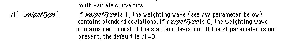

Well this must be a "new" feature. I am using igorpro v 6.37 (last version 6). Attached is a screenshot of the flag you are quoting.

In reply to Well this must be a "new"… by Dolbash
There are no changes here! As it says in your screenshot, the default (no flag) is the same as /I=0, meaning the weighting wave contains the reciprocal of the standard deviation.
Least squares minimizes the sum of the squares of the residuals, where the residuals are (fit(Xi)-Yi)/sigma(Yi). If weight W is specified as 1/sigma, then you minimize the sum of squares of Wi*(fit(Xi)-Yi). So a weight of zero excludes a point from the fit, and with increasing weight a point has increasing influence on the fit.
