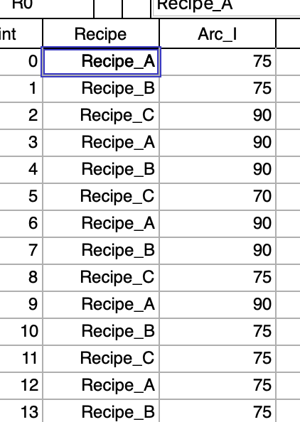

And feeding in some data gives
One noteworthy thing is that we have to declare the wave wvText with /T so that we can read from it into a string. The same approach would work if wave is a wave reference wave or datafolder reference wave.
