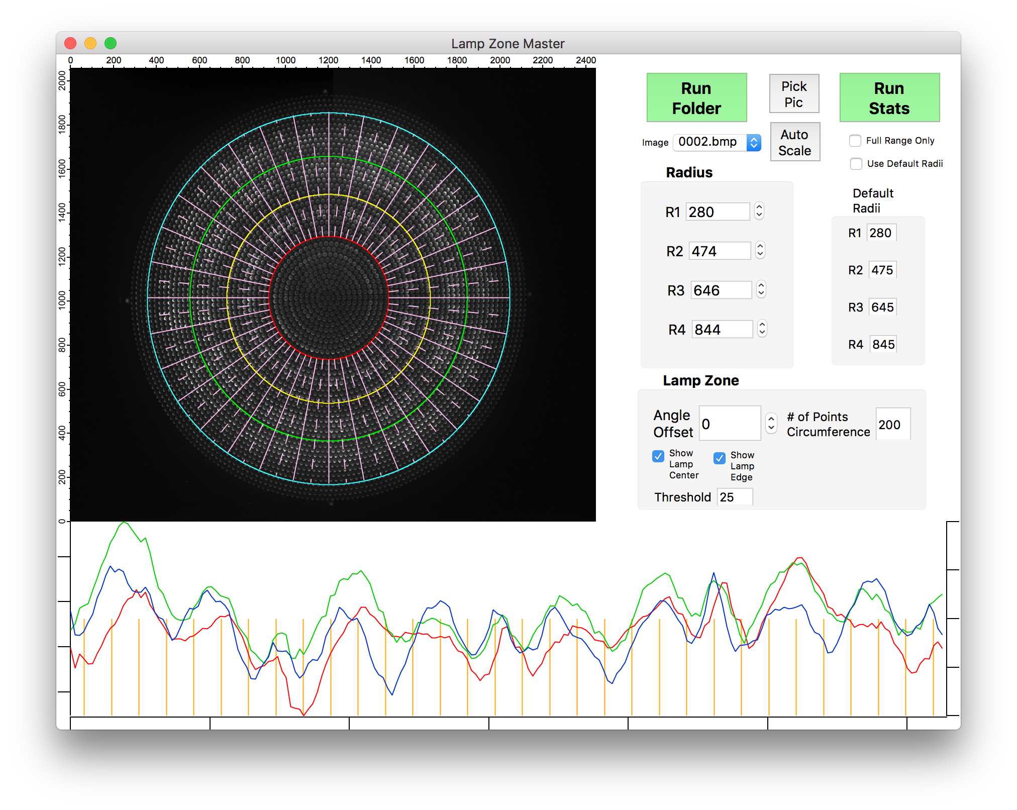

I am working on a cross platform project that has a fairly involved GUI. Due to the nature of the display differences I need to enter position and size corrections to the control objects in window macro. To do the is I have some code in the window macro that reads the screen resolution and compares it to the 72 dpi default on the Mac. I then multiply the ratio in the position and size fields.
Variable PC = ScreenResolution/72 // correct for screen resolution
GroupBox DefaultRadii,pos={772.00*PC,130.00*PC},size={94.00*PC,181.00*PC},title="Default\rRadii"
When I tweak the layout with the tools and add new elements, I run into a bit of problem/issue, when I update the window macro it inserts the current values with just the number removing the correction term "*PC".
I then have to go back and modify all the fields again.
Is there an easier/automatic way to do this?
Can we add this to the wish list?

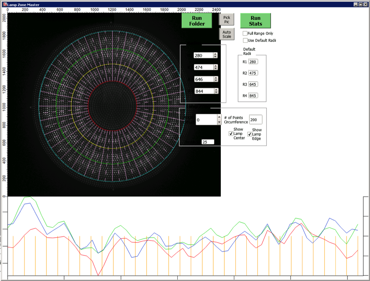

The client is running on a Windows based server and I am developing on a MacBook Pro. I have no access to their machine so I do not know the details of the screen. Often the client remotely logs into via remote desktop.
We are both using IP7. If I include code to test for the screen resolution and adjust the position and sizes accordingly then the window with controls looks as I intend. If I modify the window to add new controls for example and choose update macro then the code with the scaling parameters is lost and is replaced by absolute numbers derived from my Mac screen.
In the manual it talks about control panel issues between the platforms and the placement of controls. The display is a technically a graph and not a control panel. Are the placement of controls handled differently with a panel as compared to a graph. I notice in the manual there is discussion of the use of the setsetigoroption PanelResolution = . Does this apply to graphs?
July 11, 2017 at 09:01 am - Permalink
In my experience, this is standard behavior.
In my experience on Igor6, you must account for screenresolution in either case.
I don't know (this is new to me). But ... I notice the caveats ... PanelResolution is NOT remembered across invocations of Igor and it only applies to the panel currently being generated.
I suspect the best answer, as you are doing your development, is to generate the panel by code, not by window recreation. Include a button to Refresh Panel. It would kill the panel and rerun the code needed to create it. I think the only safe situation to use window recreations will be the end case after you have locked in the control positions forever and always. Even then, under Igor6, I'd not be sure that a recreation created on one screen resolution will translate identically to another. Reading between the lines however, assuring clean translations of panels is what PanelResolution in Igor7 is supposed to solve.
