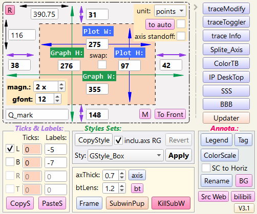

I am happy to invite you to use the procedure package I have collected and put together. I apologize that in some places I have labeled the sources and in some places I have not.
They work well on my computer.
For the graph containing a lot of tracks, "traceToggler" may or may not be sufficient for your needs.
Clicking on it will bring up a new panel that lays out all the traces, while each trace is assigned an "X", a "C" and a check to delete, copy or hide the corresponding trace.
The version of procedure package I put here is a personal remodified based on some project or code snippet from other igor users.
PLEASE forgive me if I may not have isted them completely, but please remind me if you find them.
the main panel is a personal modifoed version based on chozo's work:
Spectra Trace Offset and Graph Size Tools - Quick-access to common graph and trace modify commands | Igor Pro by WaveMetrics
the tracetoggler also can be find in:
Trace Toggler (wavemetrics.com)
and the code for coping and pasting trace can be accessed in:
copy/paste trace formatting | Igor Pro by WaveMetrics
November 5, 2023 at 12:36 am - Permalink
Hi Qianlix, it seems your package is based heavily off my Graph Size Tools project, which is totally fine!
However, I would like to ask to the following to avoid confusion:
Thanks for your understanding.
