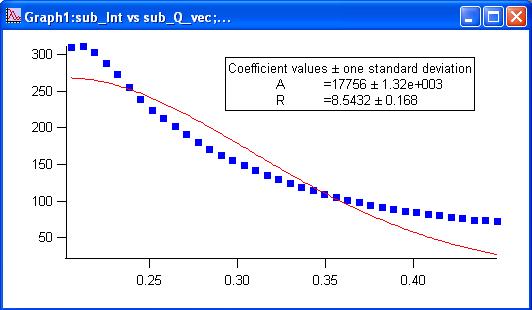

Well, after the function is defined, I used it to fit the curve that follows an exponential decay (See attached image).
Upon the fitting, I was asked to provide some initial guess for the values of the coefficients that I wish to calculate.
Some approximate numbers were therefore put in for the evaluation.
But apparently it didn't fit well at all. The fitting curve isn't steep enough as compare to the actual data curve in the graph.
By increasing the coefficient R in the exponential term and changing the number for A won't make the fitting better though.
Is there another way in Igor to make a better fit than this.
Any suggestions? Thx!

[quote=Igor_user]Problem in the fitting:
.....[/quote]
First ...
Is your equation valid (my quick search on Guinier equations give a few other forms)? Is it a proper approximation to a truer equation that should instead be used (because you are not in the proper range of parameter space to apply the limiting form versus the expanded form)? Are you missing any parameters in what you are fitting (perhaps because your experiment includes other factors)? Did you code the equation correctly (this happens a lot!)?
[quote=Igor_user]Is there another way in Igor to make a better fit than this.[/quote]
You might instead want to address the above questions first. Your results from fitting may indeed be limited by the accuracy of your equation as a representation of the experiment, not by the ability of Igor (or any other program) to fit the equation to the data.
After all this ...
Can you adjust the fitting parameters manually to give a truer fit of the expectation to the data than shown by your results? If so, start from those as the initial guesses.
