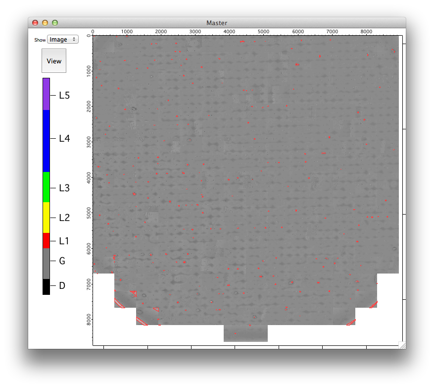

I have a large image (8960 x 8960) that is made up FP values in the range of -1 to +0.75. This is height data off of a Zygo metrology tool.
I am attempting to do some particle analysis on this data to highlight high and low stops.

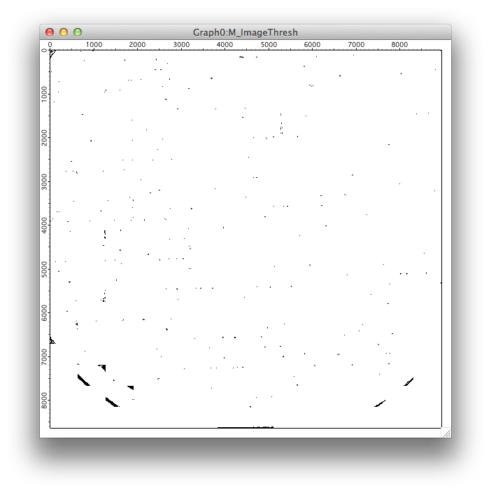

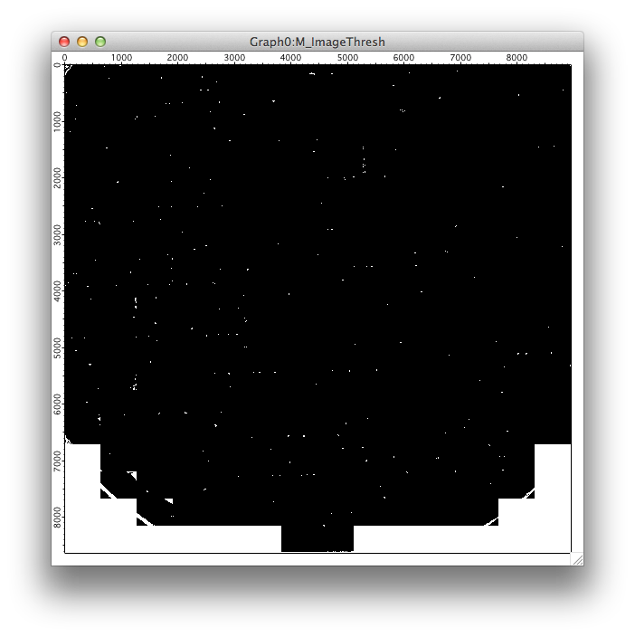

Question about which is particle and which is background.
You mentioned that 255 = background and 0 = particle
I ran the imagethreshold with an interval with two cases with and without /I
I have set the interval at 0.1 and 0.8.
In Image without I Flag and this gives me an out of memory error.
With /I Flag
The the areas in the interval are now white (i.e. 255)
This works and does not give me the out of memory error.
It appears that regions of value 255 in the threshold mask are considered particles.
May 6, 2013 at 10:43 am - Permalink
I'd be very careful with this and verify (by placing a cursor on the image) that the pixels in question are indeed 255.
You need to use ImageThreshold with /i flag to create an input for ImageAnalyzeParticles.
