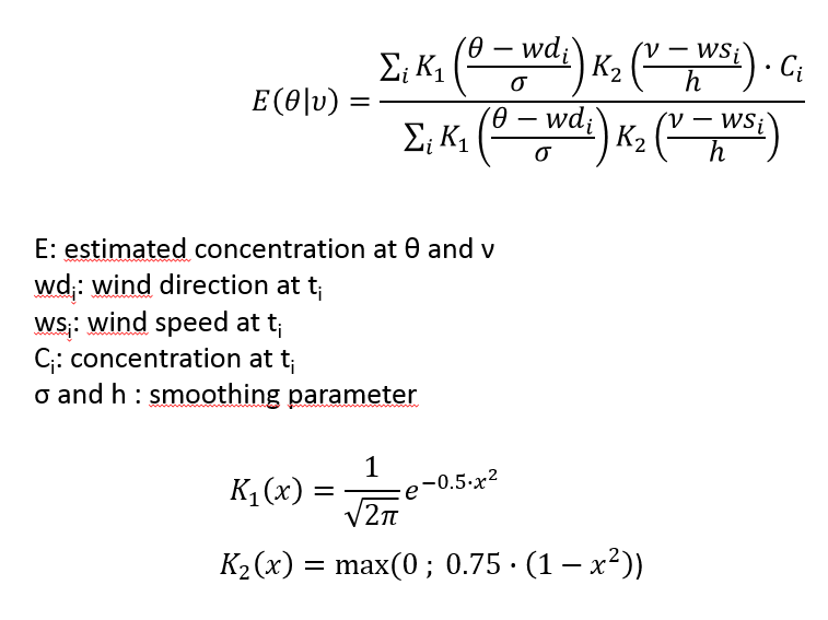

I am working on the adaptation of a Python script I made to an Igor procedure for Non-parametric Wind Regression. First, what is NWR? it is a smoothing algorithm to better visualize the coupling of wind data (direction and speed) and pollutant concentrations. I enclosed the formulas associated with the methodology. It is basically, for each (theta,mu) couple a weighted average of concentrations where weighing coefficients are determined with two Kernel functions.

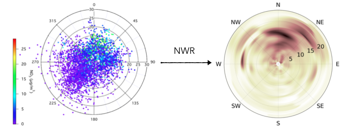

yep, it is a sort of interpolation. The ultimate goal is to have, for any wind direction & speed, a concentration value. All this from discreet variables at the input. Does it make sense to you? I enclose an image that may be clearer than some words.
Would the Interpolate XOP be useful here?
March 12, 2015 at 04:35 pm - Permalink
If the image on the left displays "scatter" of points were data are sampled, I'd approach the problem differently.
March 12, 2015 at 05:01 pm - Permalink

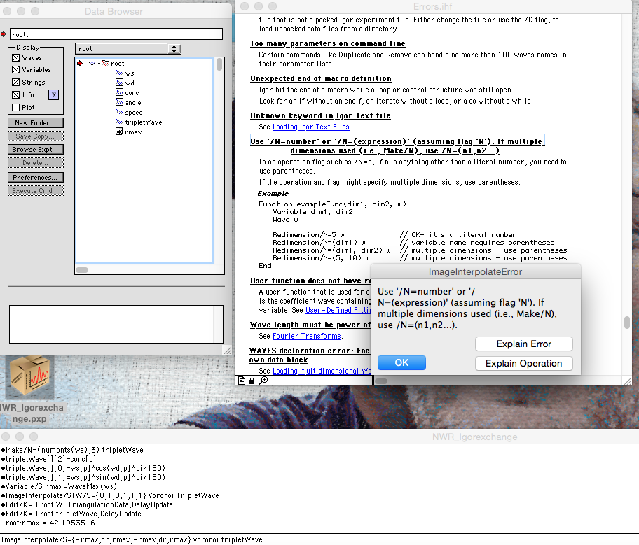

ImageInterpolate/S={-rmax,dr,rmax,-rmax,dr,rmax} voronoi tripletWave
see attached image
maybe I did something wrong... but it seems like the "dr" variable is not defined. Is it related?

ImageInterpolate/S={-rmax,dr1,rmax,-rmax,dr2,rmax} voronoi tripletWave
but I get the same error, which is not very logical to me, because the ImageInterpolate operation doesn't need a /N flag....
