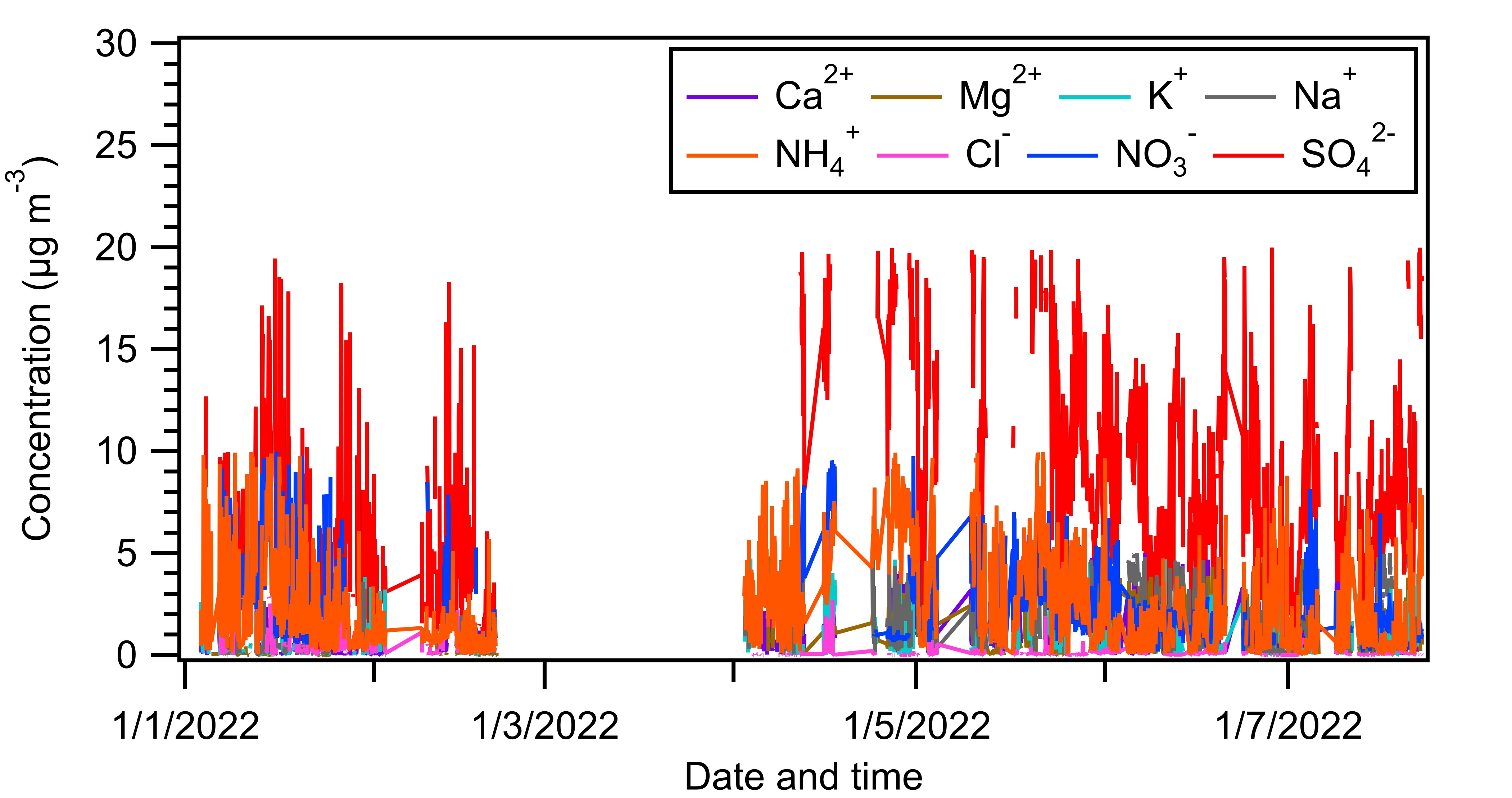

I am trying to plot a time series (1 year, Jan to Dec 2022) of the concentration of a measured air pollutant (y axis: concentration, x axis: time and date). There is a 3 month time period (Feb to Apr 2022) where there is no data because the instrument malfunctioned. How do I plot make a single time series of this pollutant with this 3 month time not shown in the graph? Basically, I want to show the data for Jan and May to Dec, and have the months Feb to Apr hidden with the x-axis having some kind of curly lines to denote this.

Here is an example. There is this blank space between 21 Feb and 1 Apr. I want to be able to change the x-axis such that the blank space will not be seen in the graph. I think you correct about split axis being what I need but I can't seem to figure out how to get it to work.

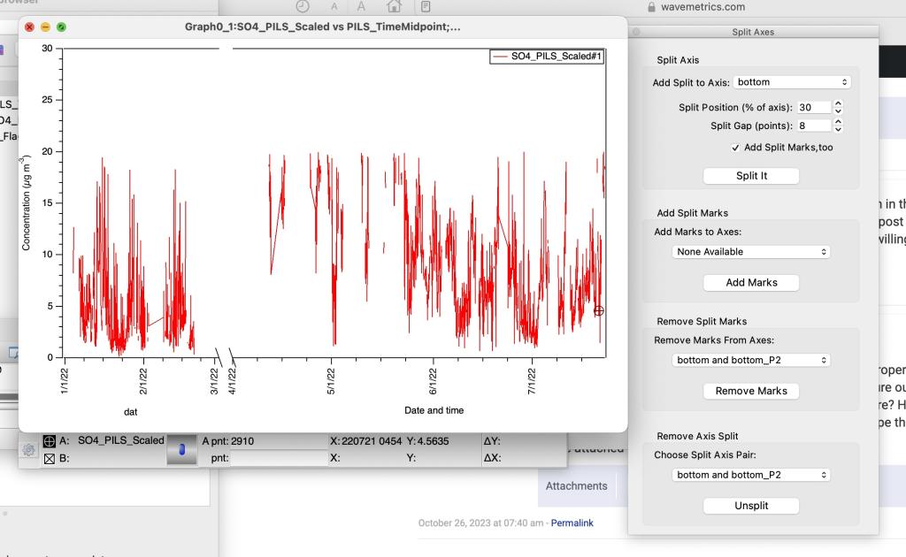

I meant that I can't seem to figure out how to get it to work properly. I think I am putting in the incorrect numbers for the "split position" and "split gap". But I can't figure out what they should be. I think the main problem is I don't under what "split position" and "split gap" are? How do I go about figuring what numbers I should key in, instead of randomly keying in numbers and hope they work?

Played with it a bit (procrastination is a wonderful thing).
Here are the settings I used for the basic split. 30% with gap and split markers.
I then went into axis settings and set the ranges. I also set the tick marks to computed with start dates and 1 month major tick and 3 minor ticks. For me, I tried to keep the distance of 1 month the same for both segments of the bottom axis so as not to deceive the eye with compressed time scales on one segment.
October 26, 2023 at 08:20 am - Permalink

Can you please explain what "split position" means? Is it the estimated position on the axis that I want the split to start?

The split position is what percent (fraction) of the axis. So for an axis that is 10 cm long a 30% split would have it occur at 3 cm from left. That is the center of spit with the gap dimension settable. Once you set this you can further examine and refine by going to axis settings as normal - double click on axis.
