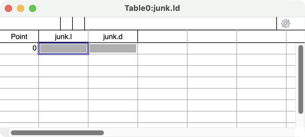

What doesn't work? The 1D case is quite different from the 2D case; the 1D case is a wave assignment, the 2D case is setting dimension label. We actually make a special case of preserving the higher dimensions even when there are zero rows, exactly so that folks can set the dimension labels. I just tried it- you can set dimension labels.
In fact, I made a wave assignment analogous to your 1D case, and that worked too. Here is what I did:
After the edit command, I had a table showing a 2D wave with no rows, and dimension labels on the columns. At the end, the wave had two rows, with each row having 1 in column 0 and 2 in column 1.

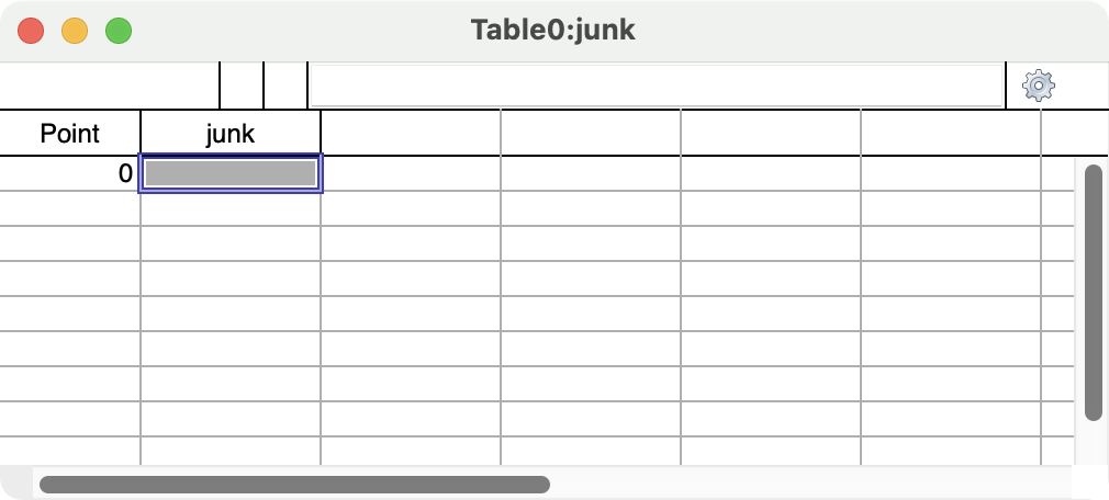

make/O)/N=(0,2) junk doesn't work it gives a single dimension wave
Executing this:
Yields this:
March 21, 2022 at 12:45 pm - Permalink
Ah, I see the source of the confusion- it's the table and Data Browser treatment that hides the extra dimension info. Usually, if you want to know the dimensionality of a wave, you start at the rows looking for a dimension with zero elements. Clearly, the table and Data Browser work that way, and just about all of Igor worked that way until a few years ago. But it was pointed out that it was useful to be able to create a wave with zero rows and non-zero higher dimensions so that InsertPoints would expand nicely when adding rows. This is particularly useful for a list wave where the dimension labels make column titles and you want to write code that creates the wave, creates the listbox and then inserts rows in response to some event.
If you execute the assignment that was part of my original answer, the columns pop into view. They also appear if you edit the insertion cell to put a single data point in the deceptively one-dimensional wave. Also:
So you see that Igor is kind of schizoid about wave dimensionality in this case. Conceivably we could modify the way that Igor does this, but given the history of this schizoidness (schizoidity?) I suspect it would take us years to find and alter all the places where this would need to be changed. The behavior I illustrate here was added to Igor specifically for that one use-case, and that explains the inconsistency. My apologies.
