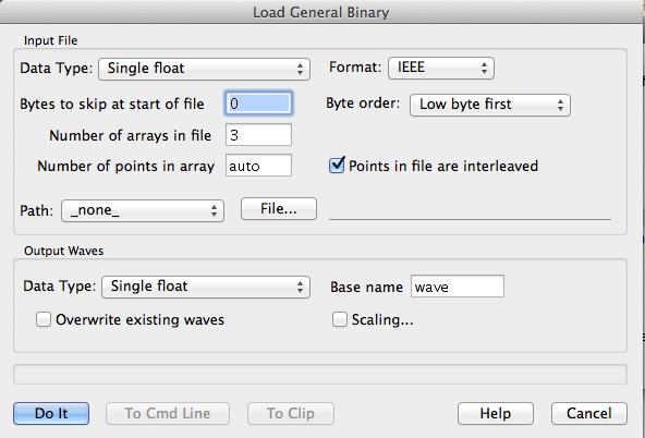

You can use Data->Load Waves->Load General Binary.
Set the dialog up as shown in the attachment. This creates a command like this:
GBLoadWave/B/V/T={2,2}/W=3
This treats the file as containing 3 interleaved waves where the data for each wave is a single-precision floating point value.
This will create three waves. The first two will be garbage and you should kill them. The third should contain the data of interest.
There is a possibility that you will need to use "high byte first" (/B=0) instead of "low byte first" (/B or /B=1).
Load General Binary.png (54.5 KB)
