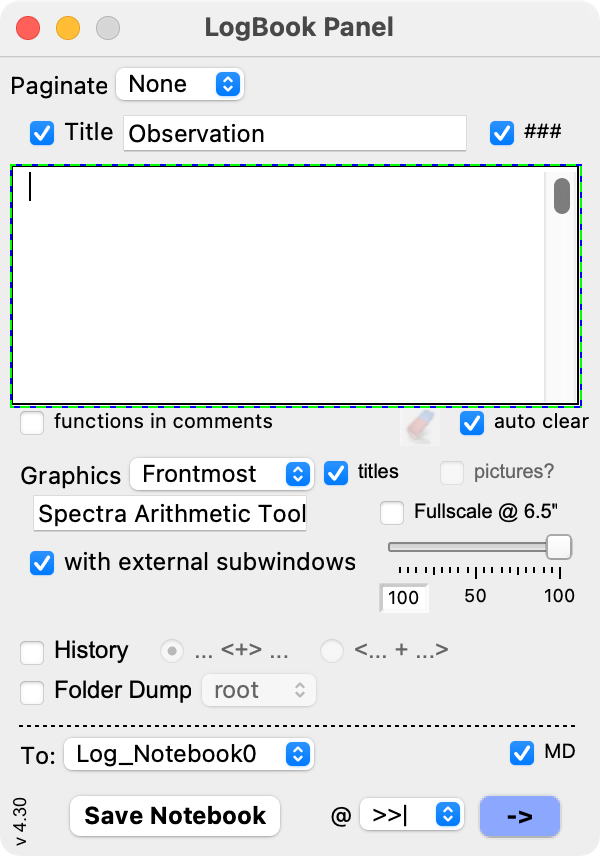

My interest is to update the LogBook package so that it is generally aware of cases where panels (and control bars) are attached to graphs. My own ImageTools package is an example. I can capture the image and histograms graph windows with the logbook windows functions. I cannot however capture the control panel or control bar without telling the LogBook panel code in advance that it should know this exception.

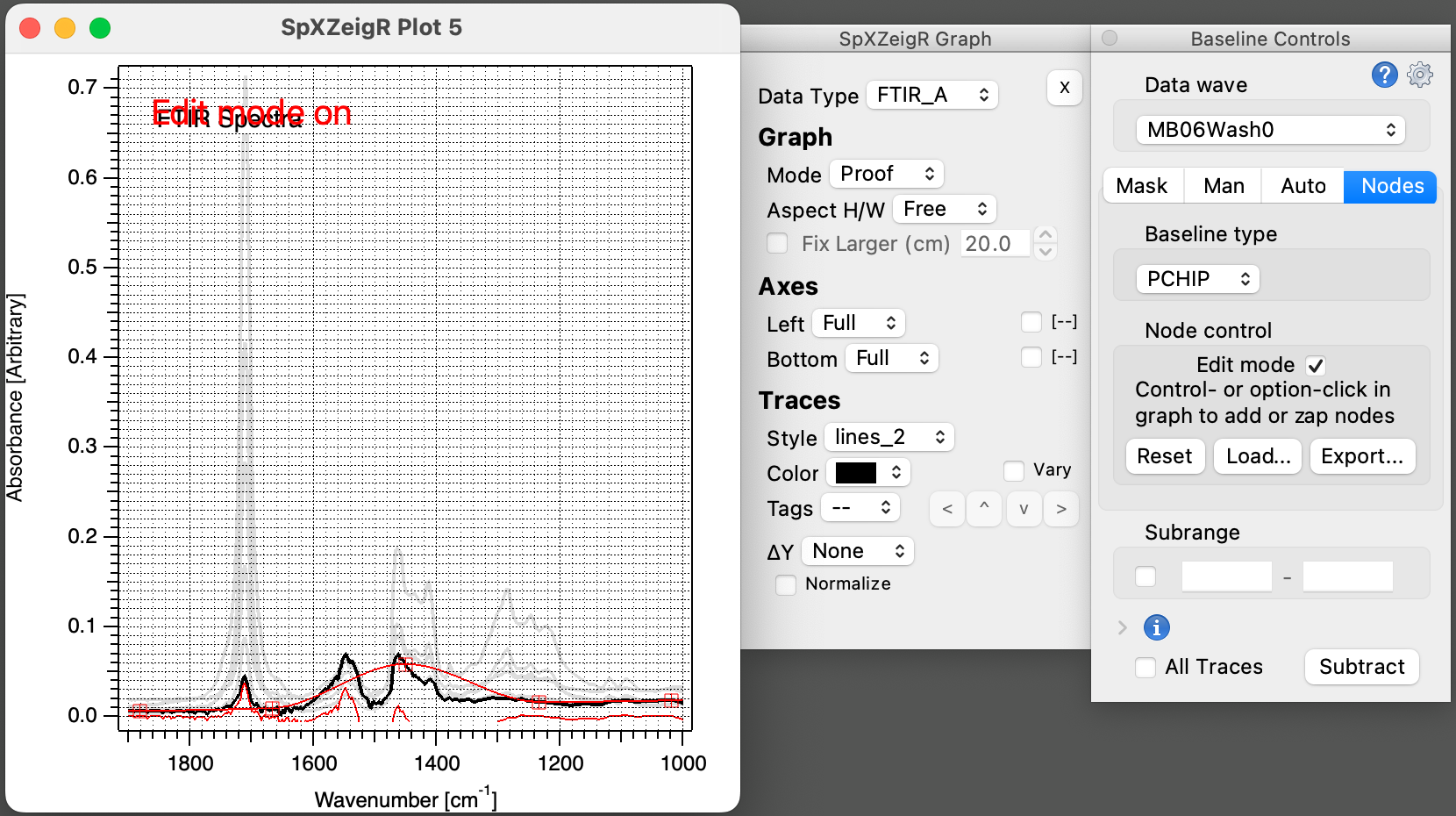

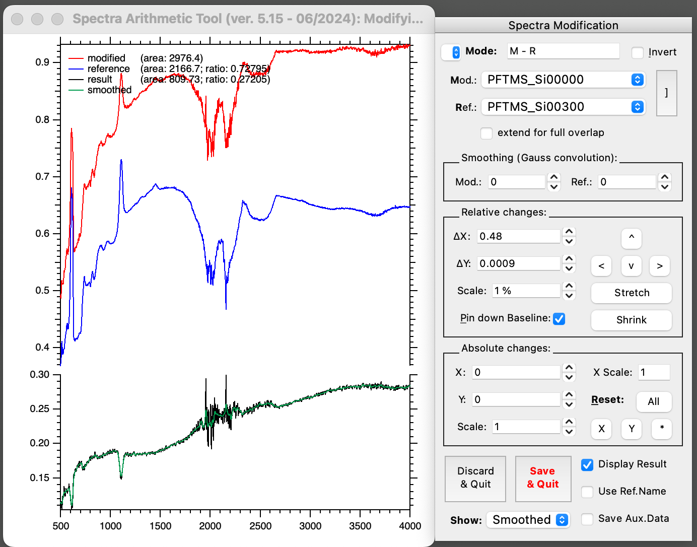

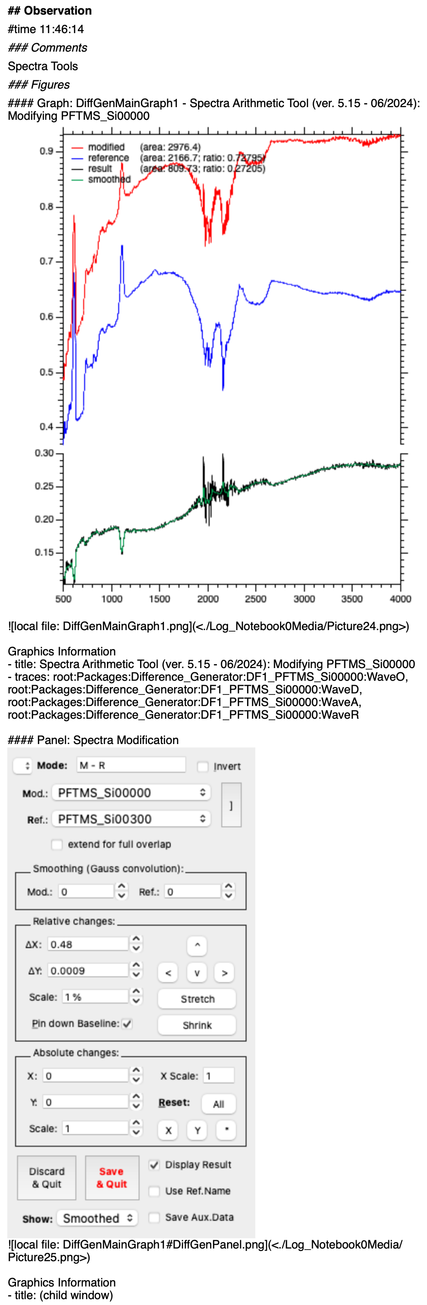

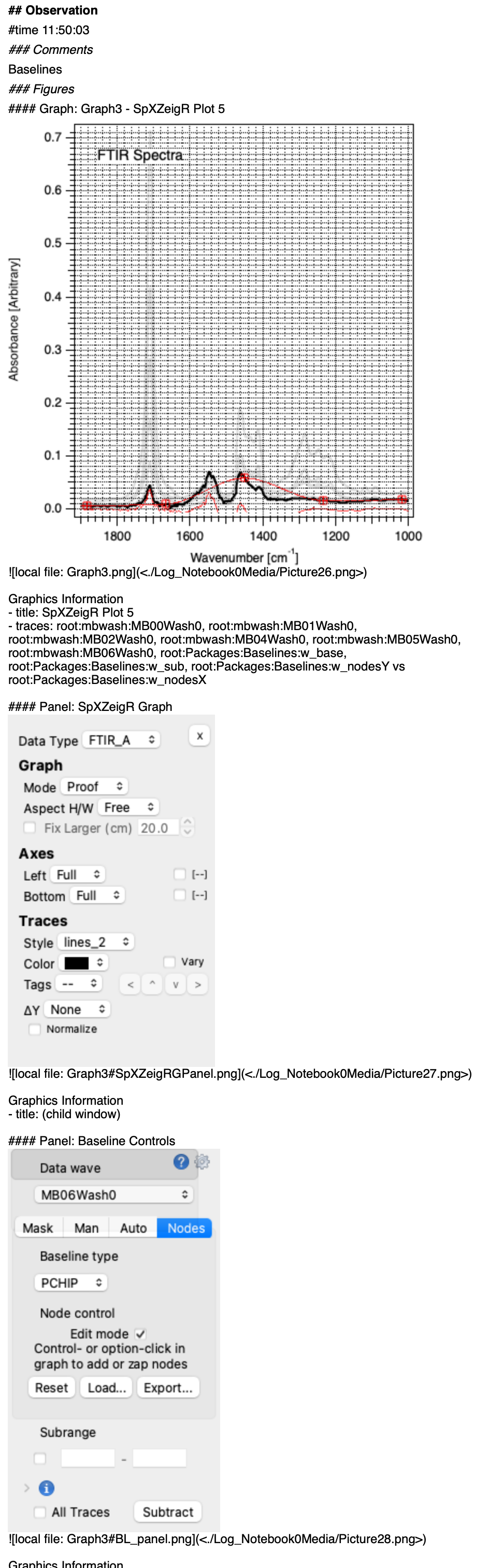

With these three functions in the LogBook package, I am now able to capture external panels attached to images or graphs and store their images in the notebook. I attach examples from Spectra Tools (you) and Baselines (Tony). The latter is a sub-panel attached to (my own internal package) sub-panel attached to a graph.
