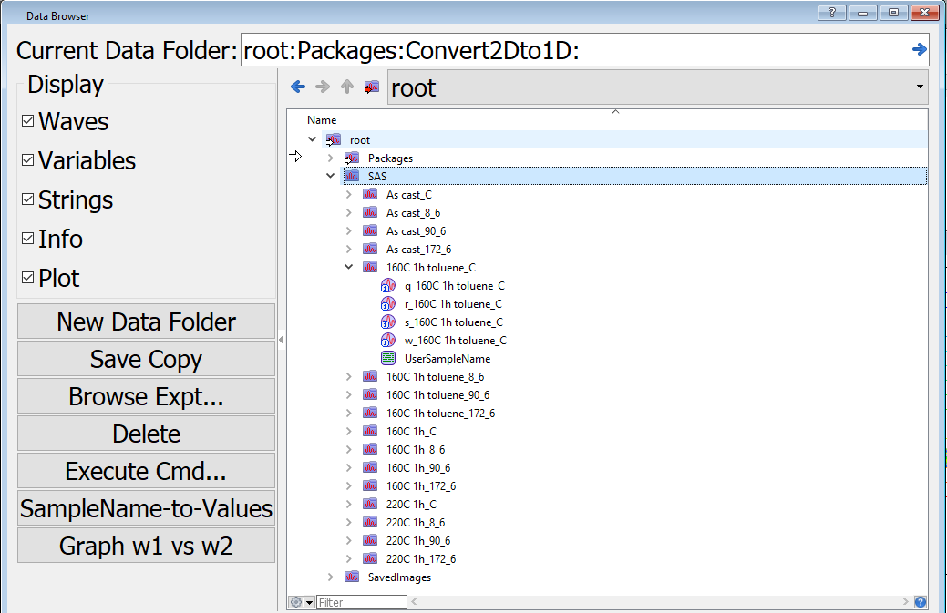

Recently I have a folder contains multiple subfolder, each corresoponding to one sample. In each subfolder, 4 waves are saved plus a string for that sample name. To export the data to another fitting software I need to create one csv file for each sample. So I want a function to help me.
1) Get the 4 waves and export it to a CSV file naming as a existing string variable.
2) Loop through the entire folder SAS.
3) (Extra function) In some cases, I need to do a simple manipulation to the wave before I export it to csv. For example, substract sample567_wave1 to background_wave1 and then save it to sample567_sub.csv. And do it for all samples.
I have no clue how to do it after I read some posts, like Save Waves as Comma-Delimited Text and Load all wave files save as tx. So I am here for any suggestion. Thanks in advance!
