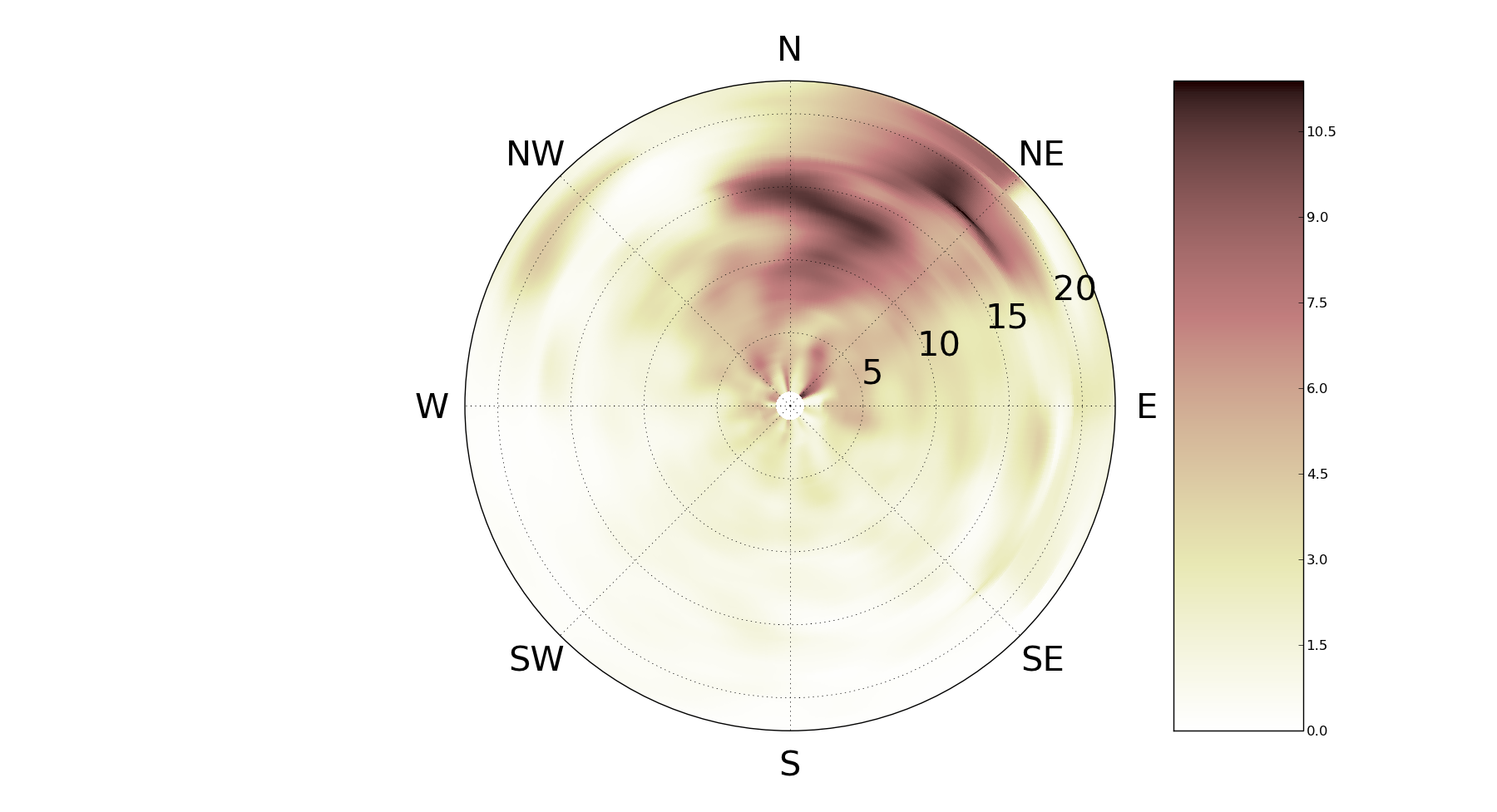

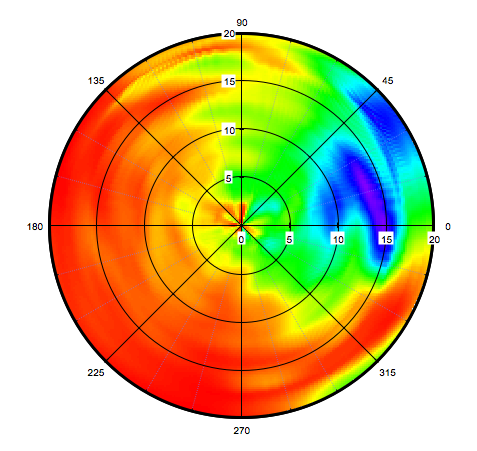

First, I enclose the polar plot I get from my Python script, which I would like to reproduce on Igor (file Polar plot Python). the polar angles are obviously associated with wind direction, and radius axis with wind speed. f(z) colors are linked to concentration values at each wind direction & speed.

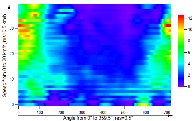

Then, I enclose what I have in Igor (already reproduce the calculation to compute mx values). Image "Image_mx". My 2D wave, called "mx", is composed of 720 rows, describing angles from 0° to 359.5° with an angular resolution of 0.5°, and 40 columns representing wind speed from 0 to 20 km/h and a speed resolution of 0.5 km/h.
The idea is then to "tranform" the rectangular image plot to polar, just like the graph from Python.

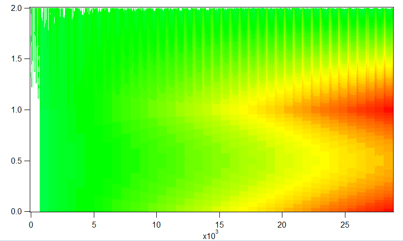

I tried the convertToPolar function, but the result doesn't look like satisfactory. (image "Contour_plt_convertToPolar"). I used 100 levels, without labels.

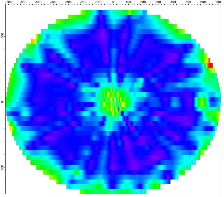

I tried the DisplayPolarImage macro, and got a polar-like graph, which is a good news! But the data used doesn't look like correct. I executed "DisplayPolarImage("mx",2,angle_rad)"; where angle-rad is a 1D wave containing 720 rows describing the angles in radian.

Before you use convertToPolar() you need to make sure that your wave scaling is indeed in radians. I suspect it might be in degrees which could explain the strange result. After you change either the wave scaling or add the appropriate factor to the "angle" variable you should get a polarTriplet wave which you can now interpolate at any resolution you want. The pixelated image you show in one of your results indicates insufficient sampling. If you use ImageInterpolate (with the keyword Voronoi) directly, you have the freedom to adjust the parameters to the /S flag and determine the boundaries and sampling in both directions. Your command would look something like:

In a similar way, I created 3 waves so that for each angle, there is 200 corresponding wind speed values; and for each (angle,speed) couple there is one concentration value. It is just a matter of wave redimensionning (code is below)

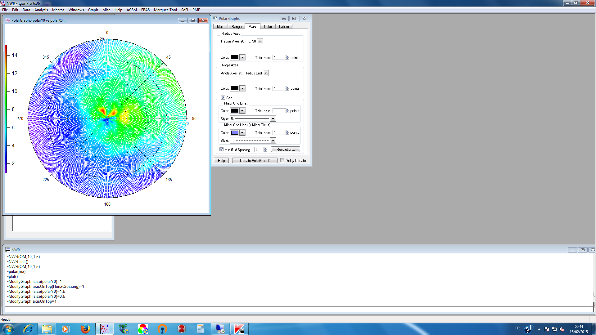

Then, I have a nice surface plot on polar axes, but the axes are all below the trace (see enclosed image). I checked the "draw on Top of Graph" button for the Vert and HorizCrossing axes, but it didn't do anything. Is there an other way to overcome this?

Please do; I think that using the Polar Graphing package for your data is not a good idea (the polar graphing macros don't provide for drawing the axes in front of the traces).
Creating an image plot and your own polar axes is more workable.

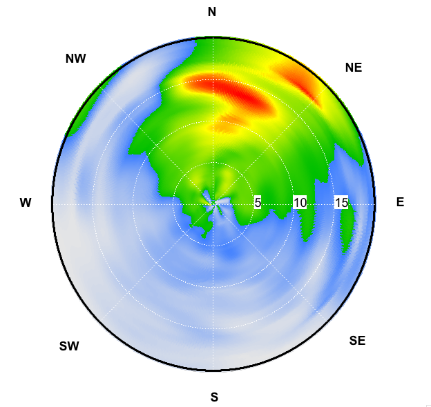

You can set the range in the Polar Graphs Range tab and the Angle Axes Thickness to mask the ragged edge a bit. See the resulting image and attached experiment.
February 17, 2015 at 01:12 pm - Permalink

I took a little bit of time to get back to your procedure. It works nicely, and what is useful is that you can change the settings of the graph through the polargraph panel. However, the calculation of mxImage take way too much time...
So as I tried earlier in this post, I plotted as a surface plot my triplet wave on a polar graph. And as the axes were beneath the surface plot, I tried to manually draw them on the graph. I don't really know if it is the most suitable solution, because one needs to interact with the "axes" through the procedure.... but it's works pretty well and it's fast....
